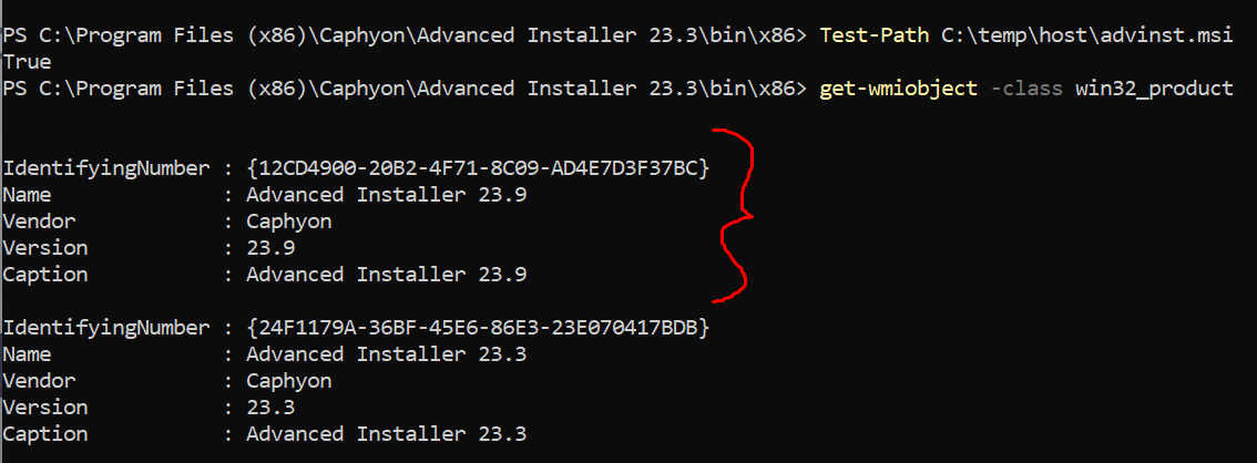

I just did a random test by installing the latest version, 23.9, in the docker container today and it suddently started working just fine.
When trying to create a new object, it worked just fine:
Note: Ignore the working folder being 23.3, it actually uses the latest one installed.
Also, the dev I am working with on this tested with a clean container, version 23.9 installed, and it worked just fine for him overthere as well.
If we have a look over the screenshots above, regarding teamcity, we can see that I also tested with version 23.9 (our latest one).
Is there a chance you can create a new container with version 23.9 and retest this with that?
Just to make sure I wasn't going insane, I did the following:
- uninstalled 23.3 completely
- installed it again --> tested the creation of a new object --> failed
- uninstalled 23.3
- installed 23.9
- tested the creationg of a new object --> it worked
