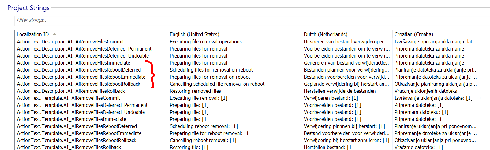

We found some strings missing translations, and are the same strings that Zsolt's installer is missing:
  • ActionText.Description.AI_AiRemoveFilesRebootRollback
  • ActionText.Description.AI_AiRemoveFilesRebootDeferred
  • ActionText.Description.AI_AiRemoveFilesRebootImmediate
Searching for it (forum wide search, search engines search, etc.), the only result I found is the Zsolt's post.
Is there a default value for them so that we can translate?
Thank you.
Posts: 7794
Re: Building a new installer
Hello Henrique,
These strings are usually added in your project when you use a file removal operation (because that's what the action does. It is a proprietary custom action of ours that does the cleanup after reboot).
However, I have tested this on a new project created with the latest version and the strings seem to have a default value, as well as being translated automatically.
In your case, something might have gotten corrupt and therefore they no longer have a default value.

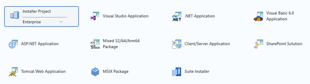

We've tried to reproduce in our end by creating an 'Enterprise' project:
Project type

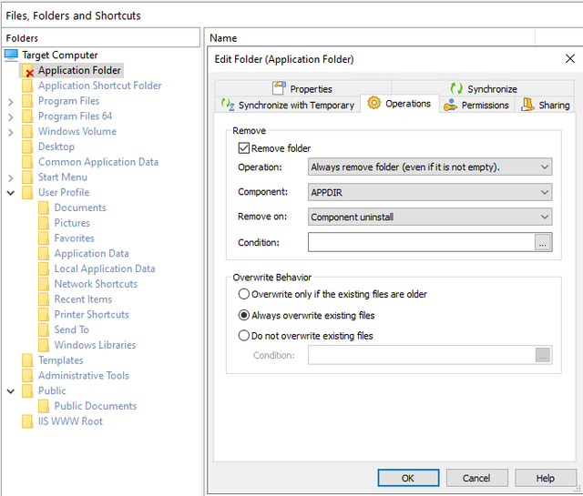

and adding a simple file remove operation on APPDIR:
Simple file remove operation

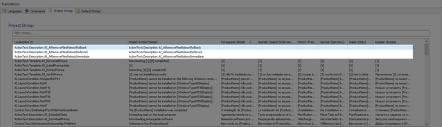

and the strings keep not being translated. Their default value keeps being their names:
Untranslated strings
Did we reproduced correctly?
Some infos that might help:
We're using Advanced Installer 23.6 on Windows Server 2022 (build 20348.4893).
We created our installer using Adv on version 20.7.1 a couple of years ago, and then updated (last year) to 23.6.
Posts: 7794
Hello Henrique,
I found out that the reason I did not manage to reproduce that is because I was on the latest version of Advanced Installer (23.9), and what you see here has been an issue that was fixed in version 23.8. :D
Advanced Installer 23.8 release notes
This was not generated by me and therefore I wasn't aware of it, just found out about it now.
That beign said, could you please try a newer version and let me know if everything is working as expected?
