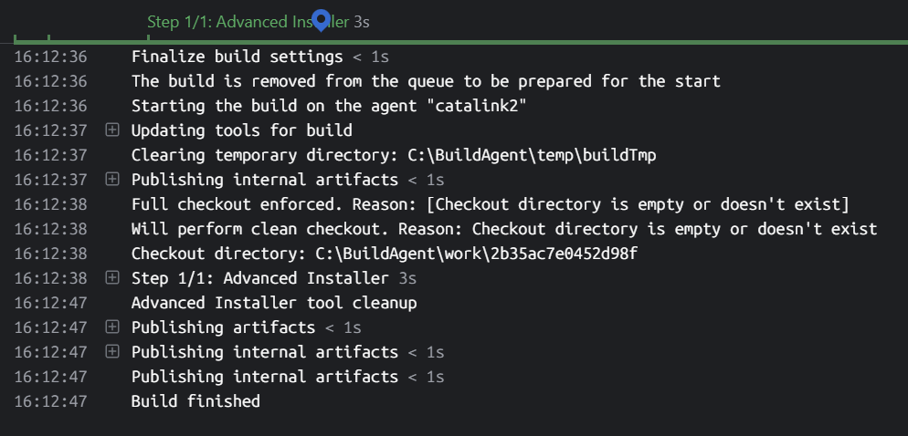

I am using a TeamCity Server to build my installer but the Agent always gets stuck without any log messages.
Both the server and agent of TeamCity are running inside a Docker Container. The build completes without issues until the Installer build Step is reached. Then the agent just runs indefinitely, never completing the task and not providing any console output.
I also tested this on a local instance running directly on my System and there it runs to completion with the same configuration.
I am using the newest TeamCity Version and Advanced Installer version 23.3

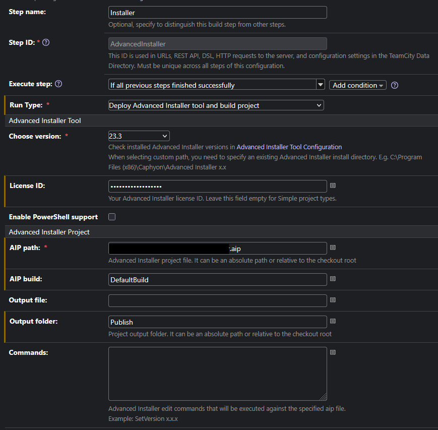

I am not sure how to redirect the output as there is no option in the plugin. Also the whole agent just gets stuck and I cannot even stop the build. I need to forcefully restart the whole agent because nothing else works.
Her is the configuration I am using for the Build:
Screenshot 2026-07-14 134128.png (69.36 KiB) Viewed 16973 times
This is the console of the most recent build on the locally running server using the same configration and project:

Thank you very much for your followup on this and for sharing the screenshots with me.
I might be wrong here, but I do not see any commands passed to the Advanced Installer in your screenshot.
For example, if you want to build the project, you should be passing the /build command in the "Commands" field.
Building from command line
Could you please try that and let me know if it helps?

I am using this official guide to setup the build step. There is no mention of explicitly adding a /build argument. As I mentioned before, this exact configuration worked without issues on my local instance.
Based on the protocol from the local instance I posted the plugin seems to call /execute to start the build.

Posts: 7794
Re: TeamCity Agent getting stuck building Installer
First of all, thank you so much for sharing the dockerfile with me.
After some more tedious work, I managed to get it working now.
The build is working just fine on my end, though.
Here is the build log:
Here is how I have the build step configured:
And here is the built MSI after the build took place:
The only difference I can think of would be the fact that I removed, for testing purposes, the "USER ContainerUser" from the dockerfile, leaving the user as admin.
With that in mind, I think that most likely this is an issue with something on your end, which unfortunately I can not tell what.
If no build log appears at all, it makes me think that the process simply hangs before it even gets the chance to start Advanced Installer.
dkuerten
Posts: 14
Joined: Tue Jan 14, 2025 1:56 pm
Unfortunately using a different user in the Dockerfile did not made a difference.
Based on your results I created a fresh installer project and added it to a new TeamCity Build configuration. The configuration only contains the build step for the installer. I tried even switching from my custom build agent container to the default one (jetbrains/teamcity-agent:latest-windowsservercore). The result was that the build produces the same result and hangs indefinetly, requireing me to forcefully restart the whole container.
When initially selected the wrong agent contanier I also discovered that at least something happens. With the wrong container it produced the following output:
Step 1/1: Installer (Advanced Installer)
13:30:42   Failed to deploy Advanced Installer tool to agent ip_<agent-ip>-2. Error: Cannot run program "msiexec": CreateProcess error=2, The system cannot find the file specified
13:30:42   Step Installer (Advanced Installer) failed with unexpected error
13:30:51 Advanced Installer tool cleanup
This at least shows that the build step starts.
Could you provide your docker configuration so I can compare it to my own?

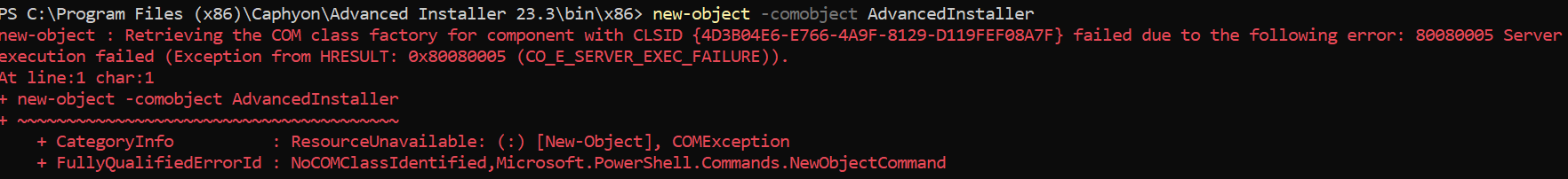

Posts: 7794
Just wanted to do a quick followup on this to let you know that I'm still investigating this issue.
I will setup a blank container and again manually install AdvancedInstaller to see if this makes any difference, but this has to wait until next week.
How did this go on your end?
I did the same on my end and I can reproduce the issue, somehow.
I am running the /register command and it is hanging, just like you mentioned.
And when I try to create a new object, I get the following:
I have two other customers that are reporting the same isse as in my screenshot above.
Although it's not the same issue as yours, I feel like somehow they might be related.
In your case, however, you mentioned that the registering of the product worked - can you please confirm this?
The issue that I have with the other two customers stems from the fact that both run the process under session 0, under the Local Service account.
In our specific case, we do not run the process under that account. However, if I did understand correctly, all processes in a docker container run in session 0 (without UI).
This made me think that the two issues might be somehow related.
Do you perhaps know if the "AdvancedInstaller.com" tool tries to access any specific Files that could be inacessable for some reason?
The only thing that it does, behind the scenes, is that it creates a pipe to communicate with advinst.exe (our executable).
What I still find confusing that you stated it did work on your setup, which should technically be exactly the same based on how docker works.
Yes, I do find it confusing a bit now as well. It did really work, as I've proven with the screenshots previously (the MSI was built, everything worked just fine).
