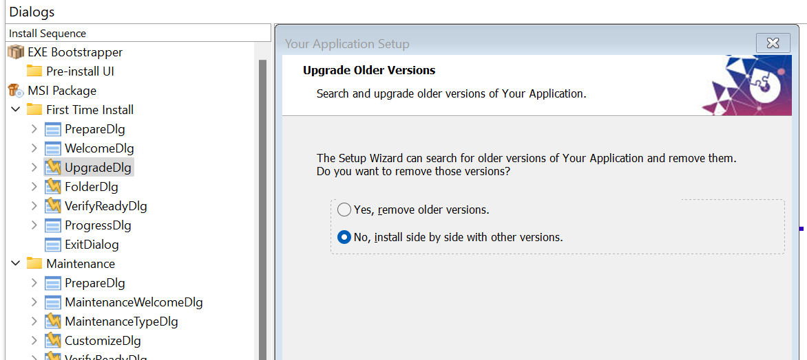

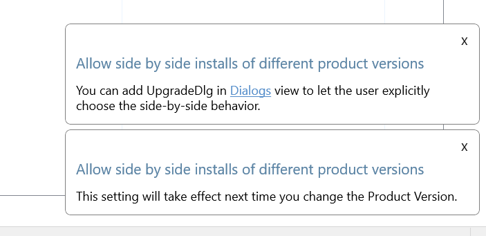

I modified our .aip and enabled the "Allow side by side installs of different product versions" checkbox and created version 1.0.0. Then from the same .aip we created a new .exe, version 1.0.1 by using the Generate new option. If we install 1.0.0 on a virtual machine and then we install 1.0.1 over it, how it should behave?
When you enable the option, you are informed that you can add the UpgradeDlg dialog, which allows you to decide during installation whether you want to perform a side-by-side installation or an upgrade.
side by side.png (17.88 KiB) Viewed 2678 times
