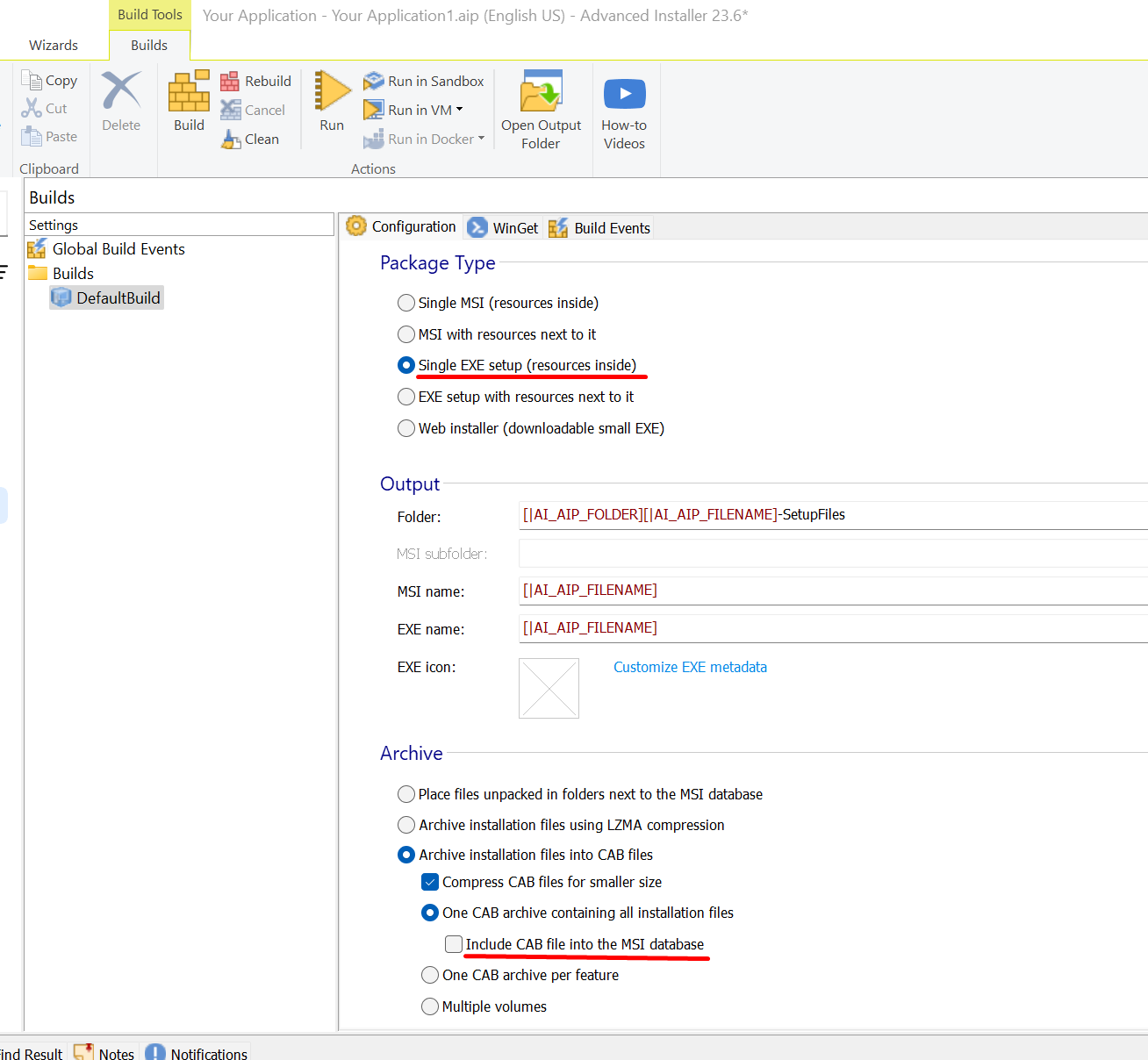

Re: MSI: 32-bit & 64-bit package for the DefaultBuild build failed

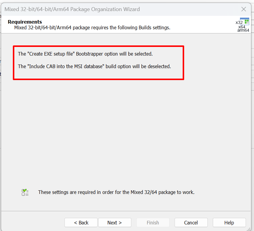

When you select the "Mixed 32-bit/64-bit/ARM64 matching the platform" option on the Install Parameters page, the build type is automatically changed to EXE setup. Also, the "Include CAB file into the MSI database" option will be unchecked.
Mixed 32-bit 64-bit ARM64 matching the platform.png (26.85 KiB) Viewed 2799 times
The project you attached contains an MSI build.
Can you please change it to "Single EXE setup (resources inside) and uncheck the "Include CAB file into the MSI database" option?
