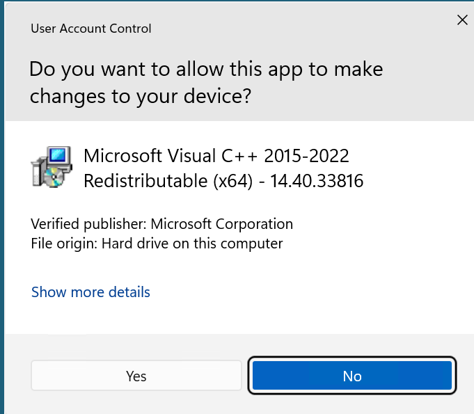

By "prompt to install VC++", do you mean the UAC?
If so, that can be avoided by enabling the "Run as administrator" option from the "Install Parameters" page.
Basically, although you are asked to elevate the setup, the prerequisite does not inherit that and therefore will also ask for the UAC. If we elevate the process from the start, then the prerequisite will inherit the admin rights and will no longer spawn the UAC.
When running silently, from the command line, you do so via an elevated command line/powershell console, which does the same as the option I mentioned - this is why no prompt appears then.
