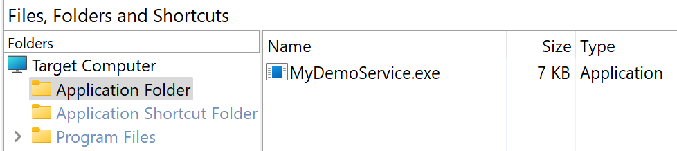

1) Add resources in the Files and Folders view

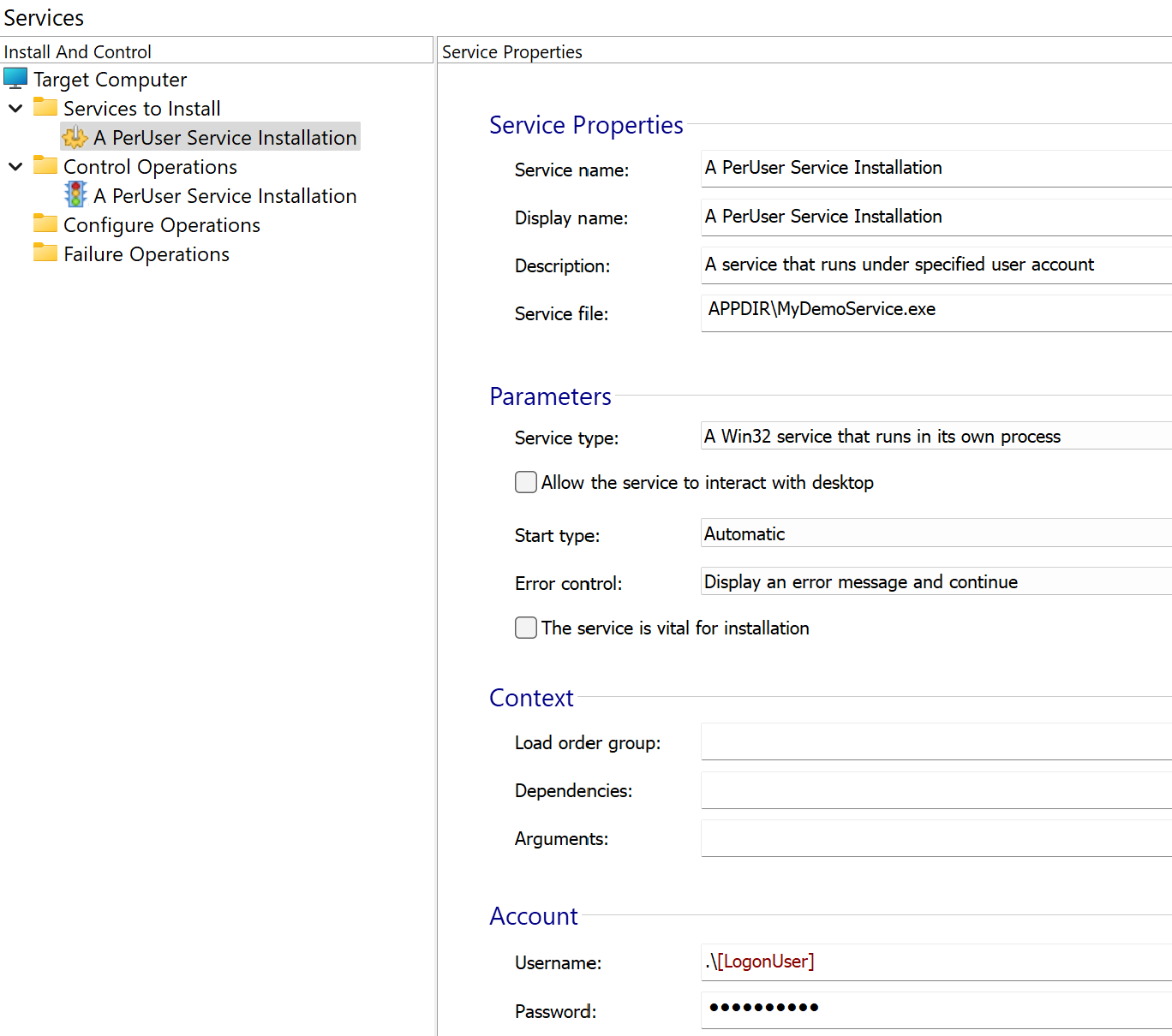

2.1 Create service that runs under the LogonUser
To configure the service that runs under specified account, make sure you specify the user and passowrd under the Account section.

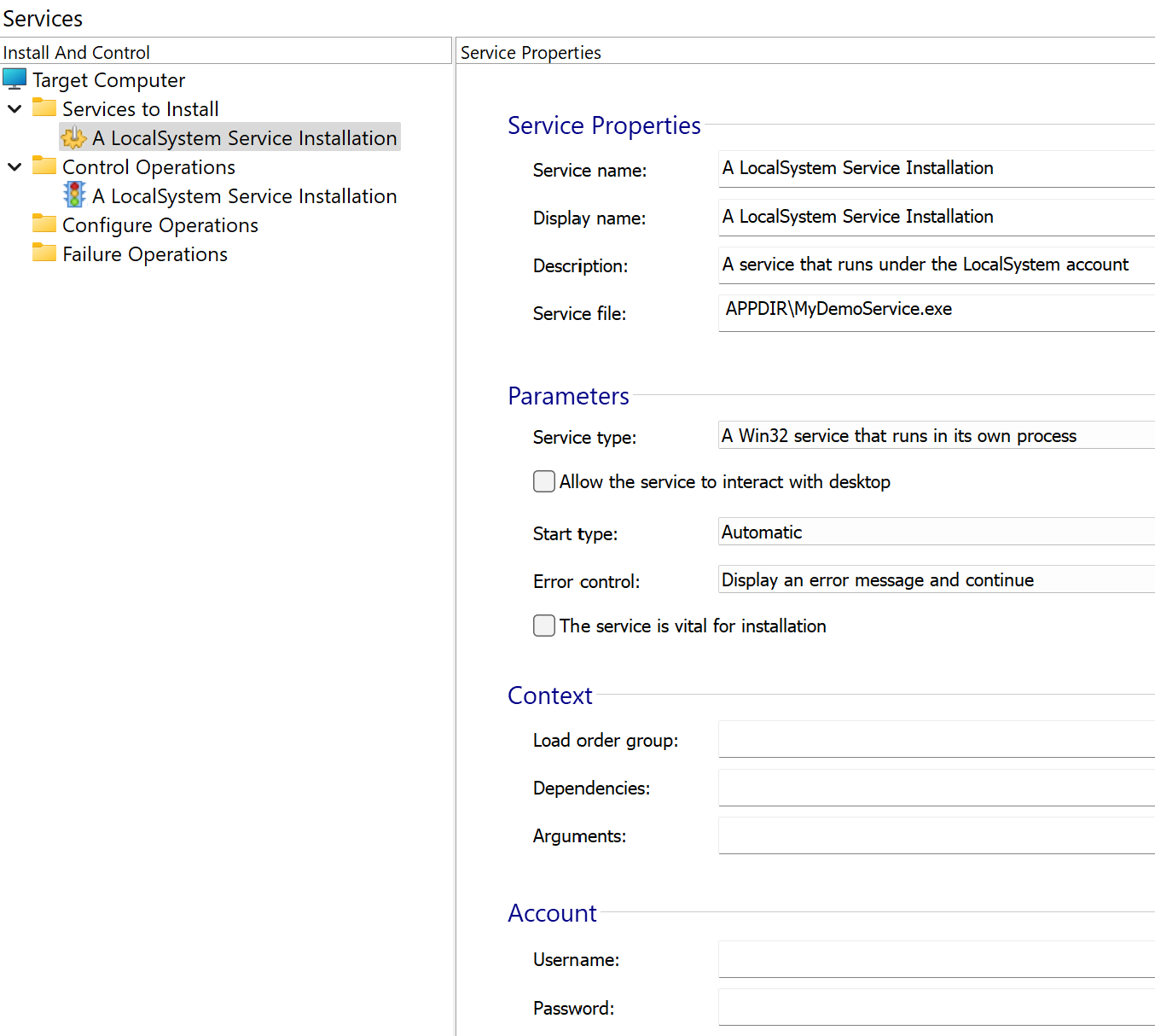

2.2 Create service that runs under LocalSystem account
Feel free to download the sample project attached.
