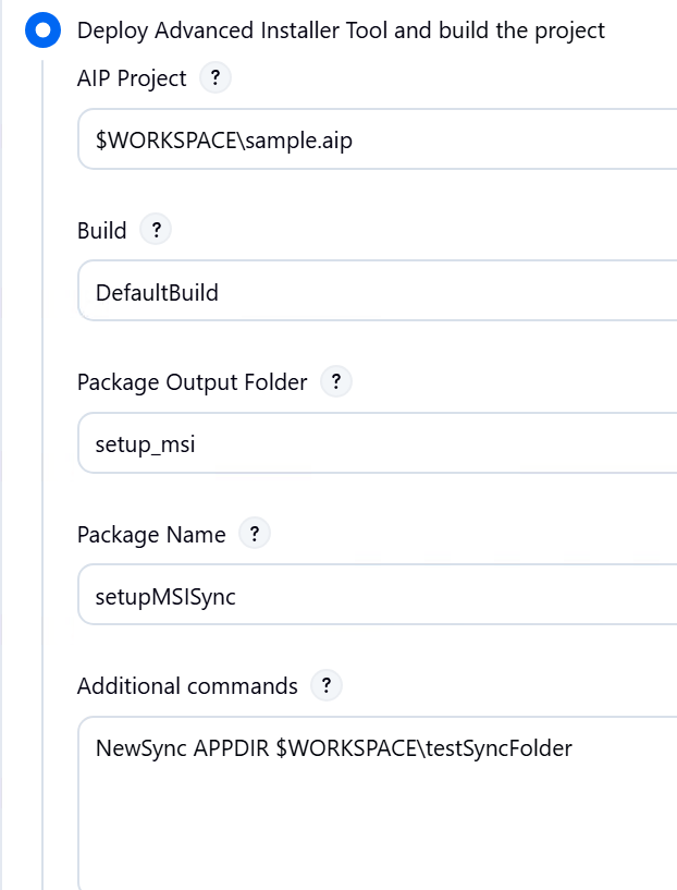

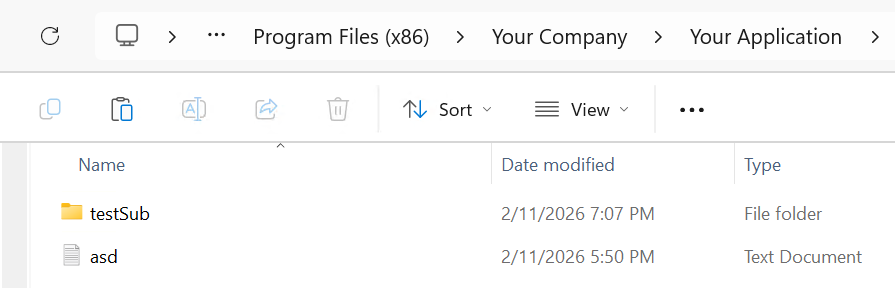

I have tested this on my end and the synchronization of APPDIR works just fine for me.
Here is the console output:
Here is how I have the build step configured:
and here is the resulted folder after installing the setup (to showcase the files were actually synchronized):
Could you please give me a more detailed, step-by-step test case so I can try to reproduce this on my end? Although the scenario is quite simple, I might be doing something wrong here.

The NewSync command is the one responsible for sync-ing the folder.
How do you synchronize it on your end?
Do you have the option enabled in your project already and from Jenkins you just trigger a build? If so, before building, could you try to trigger the synchronization from the command line just like I did and let me know if that helps?
