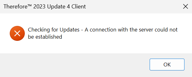

When I'm trying to test with the updater, it says that it can not connect to your server.
Here's what I did on my end:
1. installed v29.4
2. went to the installation folder (PFX86) and launched the updater from there
With the newer version, 34.0, you provided a .TUIC file (you sent the EXE and the TUIC file) - should I do something with that? I tried copying that in the installation folder (where the updater is) for version 29.4, but it didn't help.
Manually entering the URL you provided in the configuration file for updater also leads to an unreachable site:

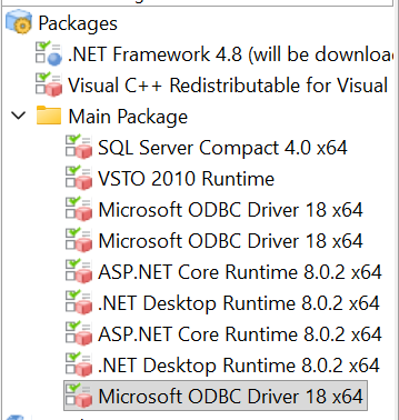

I have also noticed that you have added this prerequisite 3 times in your project and it doesn't seem to be any difference between them, so not quite sure why you added it 3 times?
Could you please try to move ODBC as "before main package" and let me know if that helps here?

On purpose we have 3 times the ODBC prerequisite in the setup, if you are searching for keyword "ODBC" you can see that those prerequisites are feature-based prerequisites, and we would like to install them only when a certain feature is installed (TheReplicationServer, TheServer, TheTenantsManager).
That´s why we would like to install them During Main Package, while the features are being installed. If none of those 3 features are selected by a user, then we DO NOT want to install them.

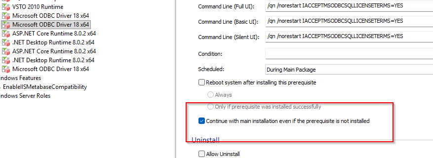

2. I will attach a screenshot, for every ODBC we turned on the "Continue main installation even if the prereq is not installed" checkbox, so we don´t know why this prereq installation problem is blocking the entire silent install procedure, and why our product is not being installed still.
