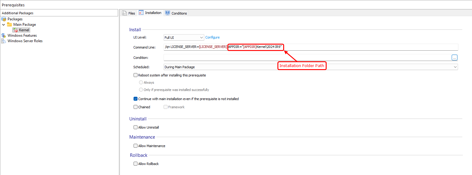

However, after migrating to version 22.3, we are attempting to implement the same method by providing the prerequisite installation folder as input through the command line, as illustrated in the attached screenshot.
Unfortunately, we have encountered a problem: while the application appears to be installed in the installed applications section, the folders are not being extracted to the designated path.

Observation:
While testing, I observed that for advanced installer version below 20.8, we are able to pass [APPDIR] value as input parameter to Install Command Lines option of Feature-based pre-requisite. But, advanced installer version 20.9 and above it is not accepting it as paramter it is treating it as a string and extracting files and folders under that directory.
example,
/qn APPDIR="[APPDIR]\Kernel\2024 IR9"
It pre-requisites extracts files and folder under "C:\APPDIR\Kernel\2024 IR9"
