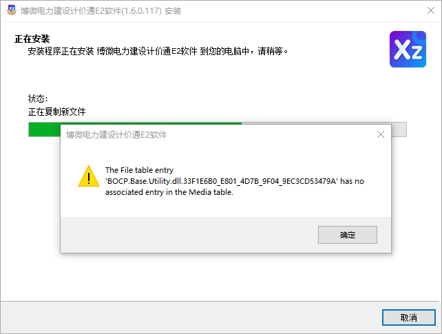

I'm encountering an issue during the packaging process on my end.
I have found that if the number of files in my main package exceeds a certain limit, this issue occurs. By examining the MSI file, I noticed that the file sequence numbers in the MSM packages start from 25000. If the number of files in my main package exceeds 25000, this problem arises. Is there any way to handle this issue?
If my exe contains more than 25000 files, adding MSM will result in an error during installation because the file number in the exe will overwrite MSM. Is there any solution?

I have provided test cases.Email doesn't seem to be able to send zip files
Posts: 4964
Re: has no associated entry in the Media table
Thank you for the sample project you've sent.
I tested it and, indeed, I reproduced the problem. This seems to be an Advanced Installer issue. A fix will be available in a future version of Advanced Installer. We will update this thread when the fix will be available.

This has been fixed in version 22.6 of Advanced Installer, released on April 8th, 2025.
