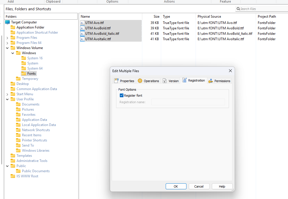

1. create a setup package that will simply deploy your application custom font; just follow the steps exposed in "How do I register a Font?" article.

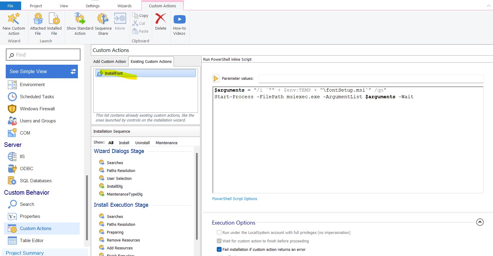

3. go to "Custom Actions" page and add a new "Run PowerShell Inline Script" custom action without sequence that will simply launch and silently install the fontSetup package; you can use a PowerShell code like this:
$arguments = "/i `"" + $env:TEMP + "\fontSetup.msi`" /qn"
Start-Process -FilePath msiexec.exe -ArgumentList $arguments -Wait

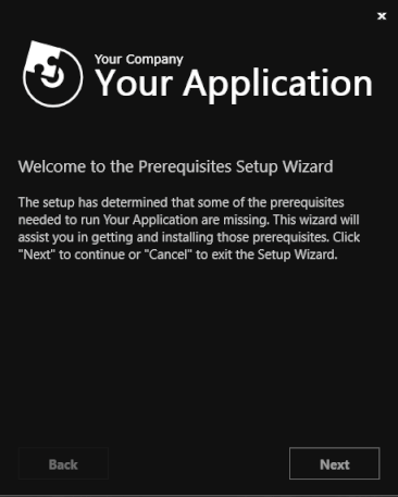

4. go to "Dialogs" page and select "PreparePrereqDlg" dialog; add a trigger for the above configured "InstallFont" custom action on "Init Event" tab - let's assume your main setup project also includes pre-install prerequisites; otherwise you can trigger this action from "PrepareDlg" dialog

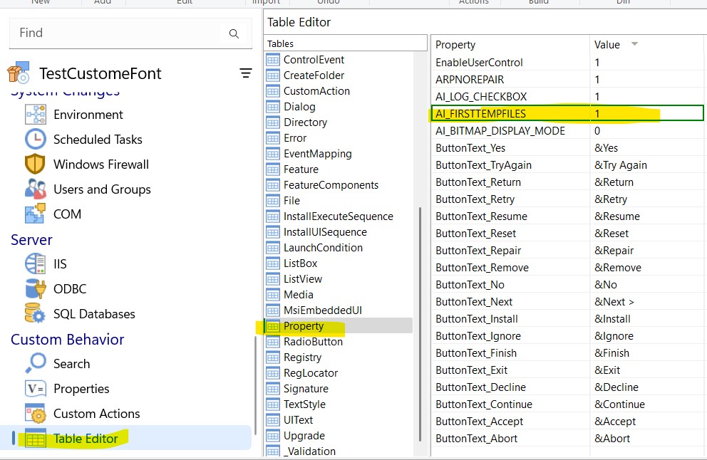

7. finally go to "Table Editor" view. In "Property" table you should simply add a new property row like this:
Property: AI_FIRSTTEMPFILES
Value: 1
8. save and rebuild your main setup project

I have tested your setup project and replicated the issue. It seems the behavior is caused by the fact I forgot to document one last step you need to configure. I apologize for this.
The last step you need to configure is in "Table Editor" view. In "Property" table you should simply add a new property row like this:
Value: 1
Can you please configure the above step too and let me know how this works now?
I have also updated this info on our web forum thread. Thank you for helping me to correct my post.

I created a new project and added properties. It works perfectly. Thank you for creating such a great guide.
