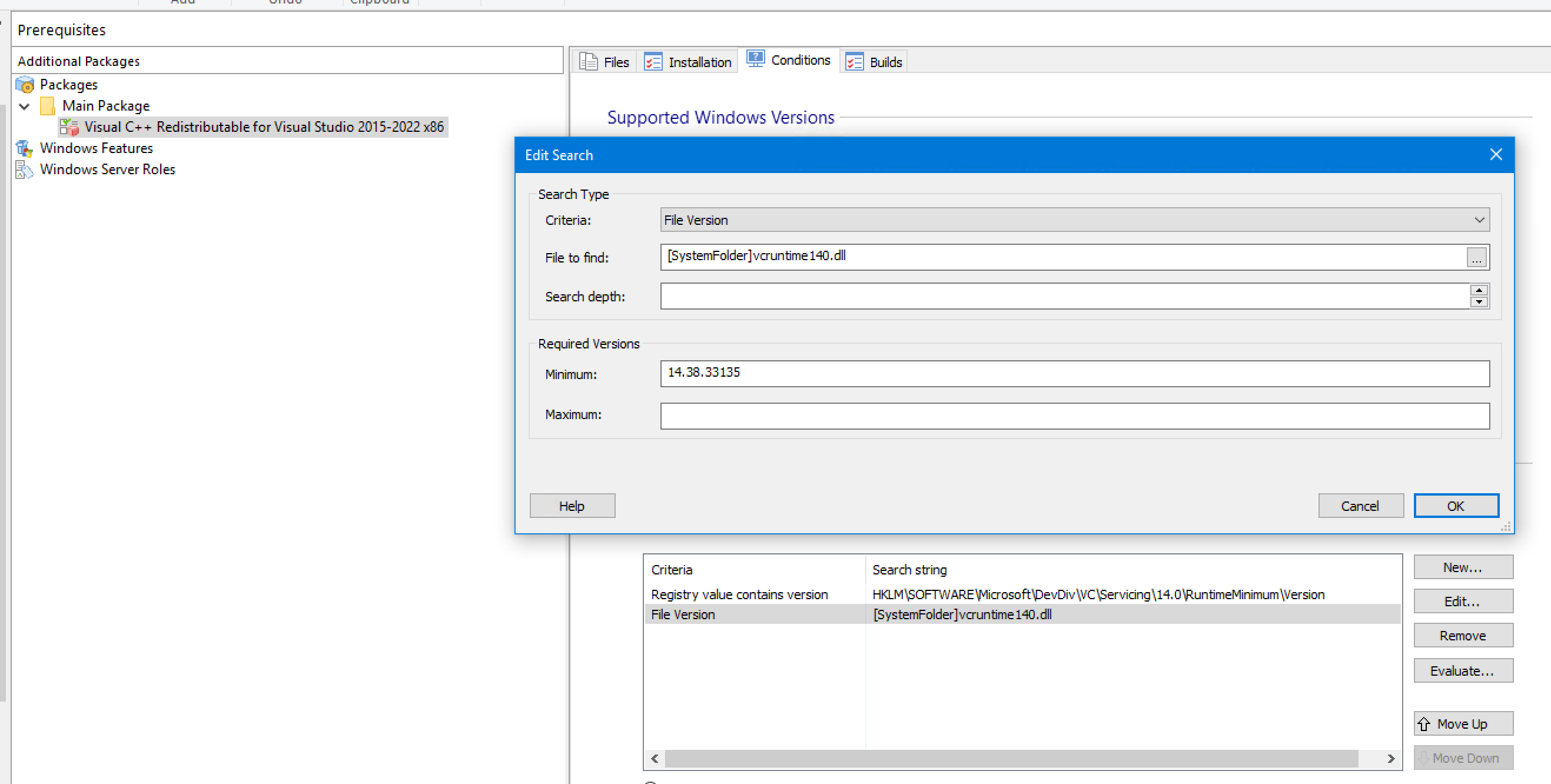

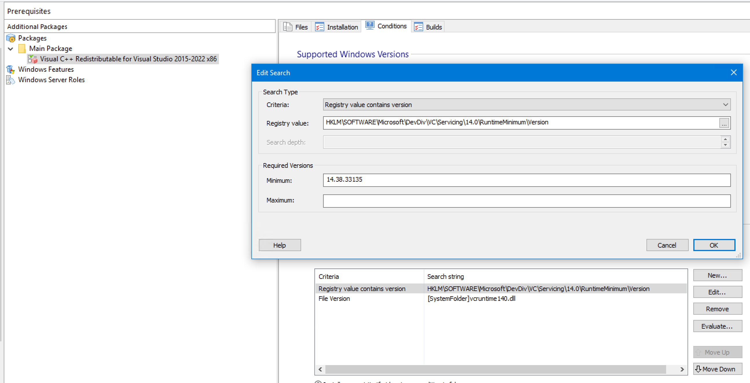

thank you for your reply. I re-checked and found the version number unchanged. I am attaching two screenshots so that you can verify I was looking in the right place. My intention was to change the minimum required version from 14.38.33135 to 14.42.34433.

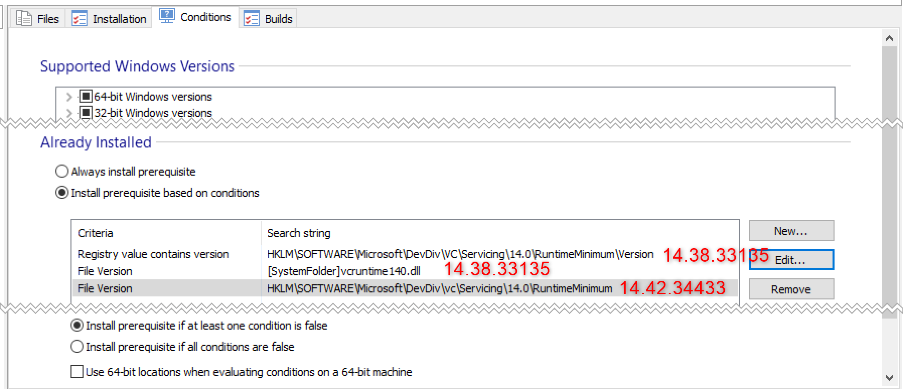

Hello Catalin, happy new year, and thank you for your reply! Your suggested command line works, but now I am a little confused. As you can see from this screenshot, it added a third install condition. The top two conditions, with value 14.38.33135, were present before I applied the command.
I wonder, should I delete the second condition, and maybe the first condition too?
Hans

I found a solution. I am posting this here for reference. Or maybe someone finds a more elegant way...
Since the prerequisite has two conditions (I don't know why, but this is how AI created it), I issue two UpdatePrerequisite commands, one for each condition. (See screenshot in my previous comment.)
The command to update the "Registry value contains version" is:
advinst.exe /edit "my_project.aip" /UpdatePrerequisite "Visual C++ Redistributable for Visual Studio 2015-2022 x86" ^
-minversion "14.42.34433" -prereq_path "<path>\VC_redist.x86.exe" ^
-search_type RegValue -search_path "HKLM\SOFTWARE\Microsoft\DevDiv\VC\Servicing\14.0\RuntimeMinimum\Version"
(The carets "^" at the end of line are line continuation markers which I inserted for readability.)
The important difference to Catalin's suggestion is that I uppercased the "VC" registry key component. Case and spelling must exactly match the value stored in the *.aip file.
The other command updates the "File Version" condition:
advinst.exe /edit "my_projct.aip" /UpdatePrerequisite "Visual C++ Redistributable for Visual Studio 2015-2022 x86" ^
-search_type FileVersion -search_path "[SystemFolder]vcruntime140.dll"
