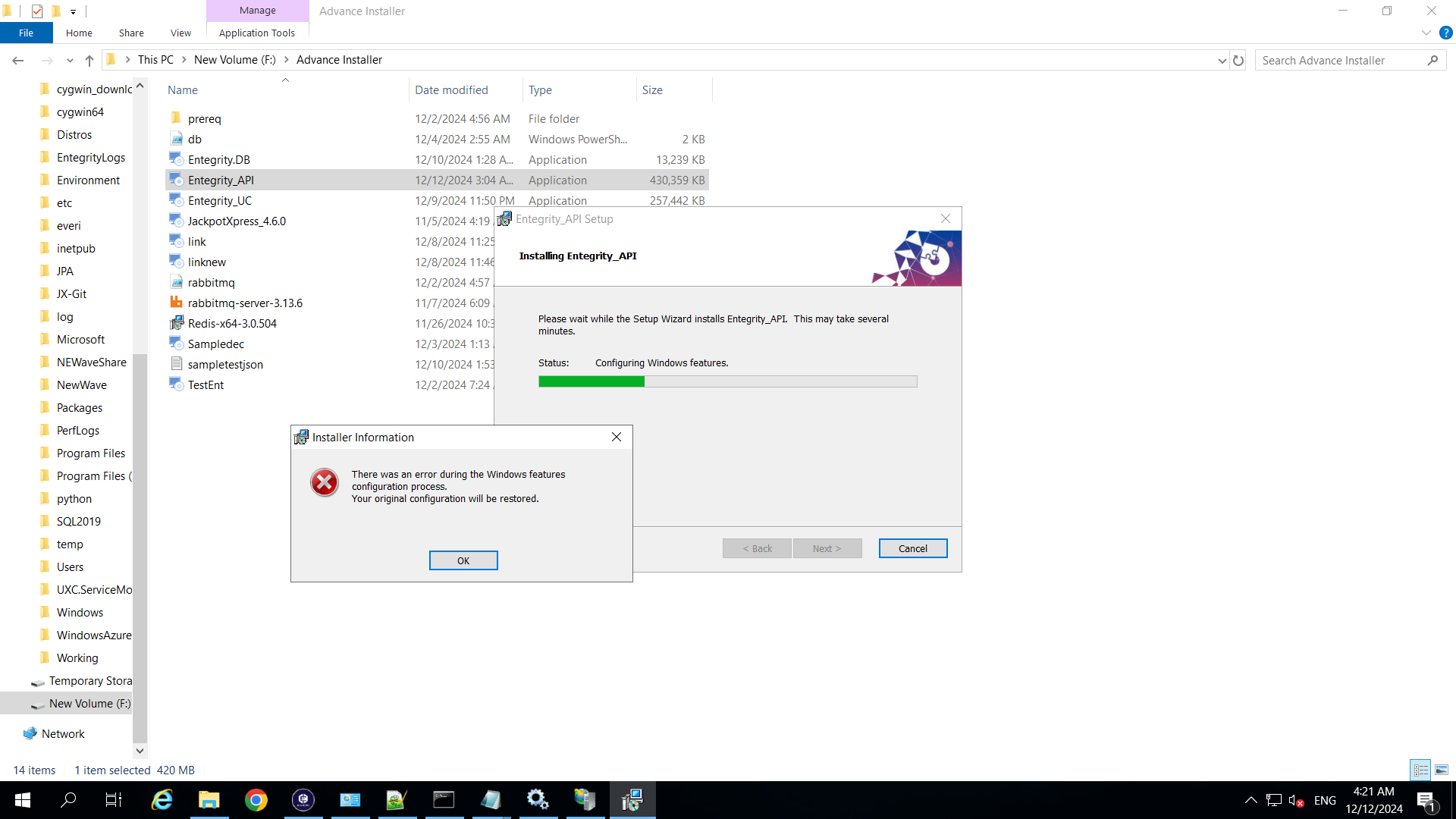

Hi , Pls help to solve this when trying to enable windows feature from prerequisites tab, exe get roll back. till that my application exe is running fine, can you pls assist.
Getting this error in verbose log,
Product: Entegrity_API -- Error 4180. There was an error during the Windows features configuration process.
Your original configuration will be restored.
CustomAction AI_WinOptFeaturesConfig returned actual error code 1603 (note this may not be 100% accurate if translation happened inside sandbox)
Action ended 2:26:13: InstallExecute. Return value 3.

Posts: 1365
Re: AI_WinOptFeaturesConfig custom action is blocking the installation
I'm not sure why that happens.
Can you please check if there is any Windows update pending for configuration?
I've seen a lot of problems caused by the fact that the Windows requires a reboot.
Also, does it work if you try to enable the Windows Feature manually (Windows key + R --> optionalfeatures)?
If the behavior persists, please send us the following resources via email to support at advancedinstaller dot com:
1. the .AIP (setup project) file.
2. an installation log.
3. a download link to your setup package.
4. the build number and version of the OS where you can reproduce this.
