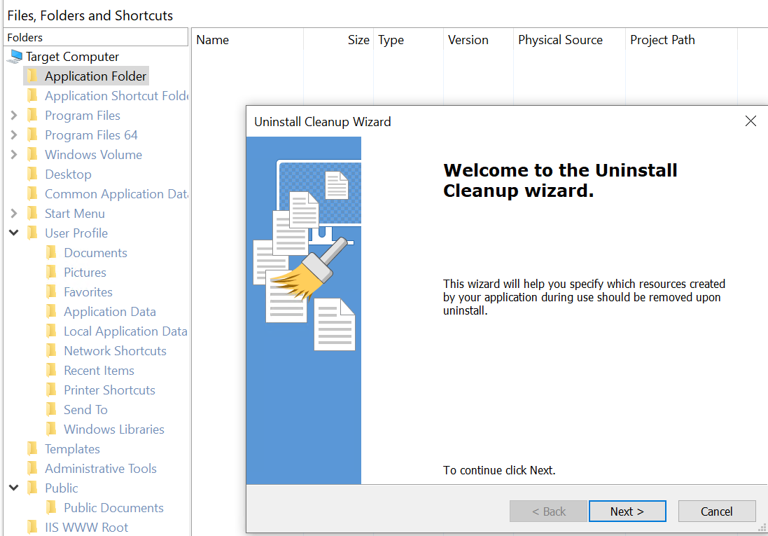

As previously discussed, this folder it's an internal Advanced Installer recycle bin and is used by our file/folder removal mechanism from "Files and Folders" page. It's a temporary folder used to store files that will be removed from disk.
The "file removal" is noted in the "Files and Folders" page with a red X sign.

No, the folder is not always used - it's only used for cleanup purposes (including file/folder removal).
Another possible cause would be the "Do not overwrite existing file" option.
