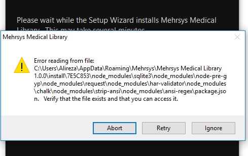

My project has many nested folders such that the length of some paths exceeds the 260 characters limit on windows.
When I use CAB as archiving method, there's no problem.
But when I choose LZMA (either 1 or 2), the resulting installation file encounters an error:
Error reading from file: C:\Users\...(a long path more than 260 characters).
Verify that the file exists and that you can access it.

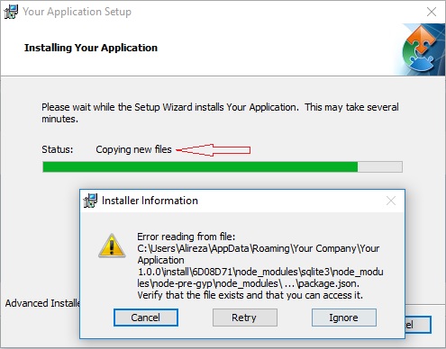

Here is the scenario:
Create a new simple project.
Add some nested folders with path more than 260 characters to 'Application Folder'.
Set 'Package Type' to 'Single EXE setup' (upgrade project to professional).
Build the project (The default archiving method is CAB).
Install the resulting file: It works WITHOUT ERROR
Now uninstall it.
Change the archiving method to LZMA.
Build the project (using LZMA and 'Single EXE setup').
Install the resulting file: It does NOT work
The error happens while Copying new files.
I think maybe it's because when using LZMA, the installer first extracts files to a temporary folder and then tries to copy them. but on CAB mode, it extracts files directly to the destination path.
