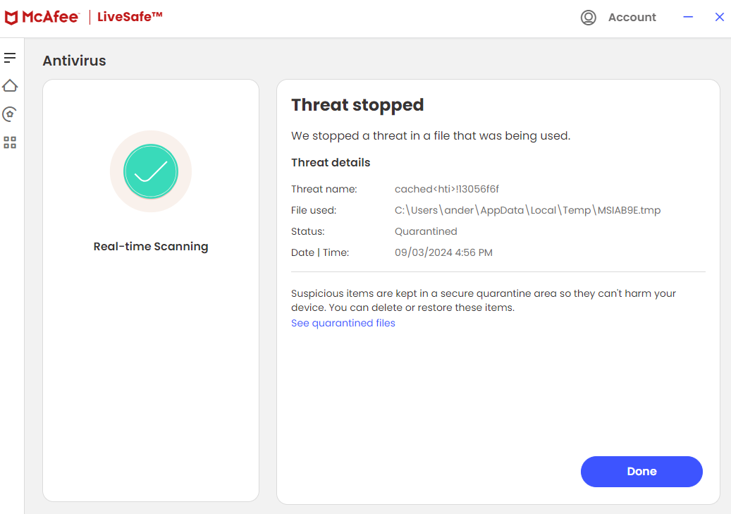

This new 22.0-generated installer triggers MacAfee and it fails. It pops up an error message that it stopped a threat

I have also attached an image of the error dialog that MacAfee put up.

I can assure you this is a false positive detection.
It seems this is a false positive detection generated by our "AI_DETECT_MODERNWIN" custom action. We will report a false positive detection for our file to McAfee team and hopefully this will be whitelisted soon. Thank you for bringing this to our attention.
In the meantime the quickest way for you to have this whitelisted is to also contact the McAfee support team and submit your built EXE installer to them for whitelisting.
