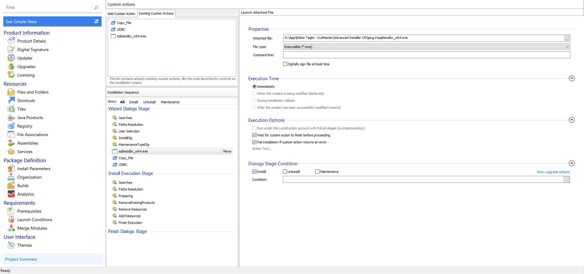

I'm building a installer with a simple exe file and some custom actions based on power shell command (copy a file from a location to another and another one who create an ODBC connection). For using the ODBC connection i need a specific driver that i want to install by the main installation built with advanced installer.
The main problem is that for every version the system call the installation while i want to call this procedure only if the software is not already installed. If anyone exit the installation of driver i want to quit all the main installation.
Sorry for my english! hope someone got my point! attached some file.

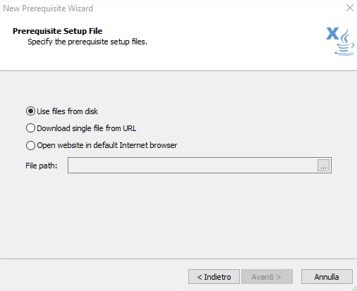

I tried to set a Prerequisites but at a point i need to set how to install that driver. My idea is to install the driver as attachment without go to any website o to network path. But this installing need to be active only if this file is not exist.

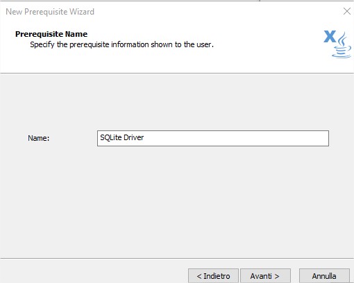

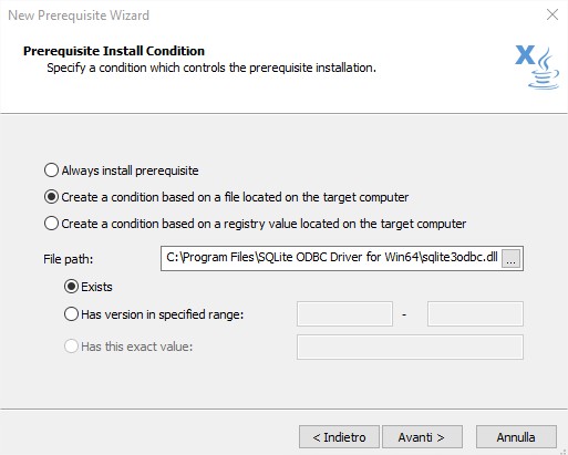

Ok i tried to set a prerequisite but i found two things while i try to install:
1. I have a new button with a custom insallation while i need just a one (wihtout custom)
2. even i click to typical installation it runs the driver exe even i already installed

Posts: 7794
Re: Install attached file (exe) only if not already installed
From what I can see, you are trying to look in the 64-bit version of the Program Files folder.
By default, this search will be redirected to Program Files (x86) if your setup is of 32-bit (you can check this in the "Install Parameters" page).
That being said, please make sure the search is marked as "64-bit" in the "Prerequisites" page --> "Condition" tab.
