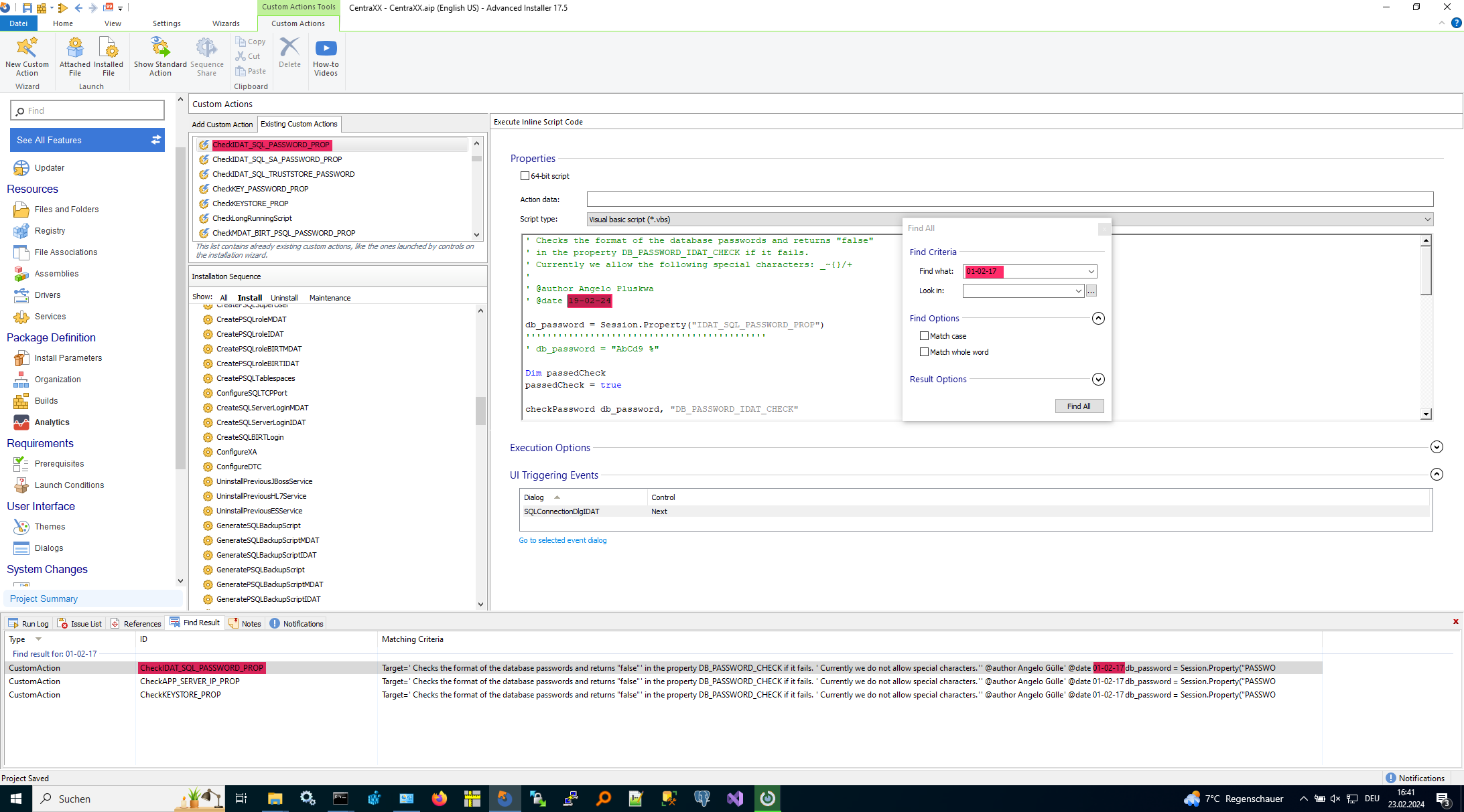

As you can see in the attached screenshot:
When searching for a date 01-02-17 Advanced installer finds the action "CheckIDAT_SQL_PASSWORD_PROP" because it searches in the "Target" attribute. But the actual date string is 19-02-24.
