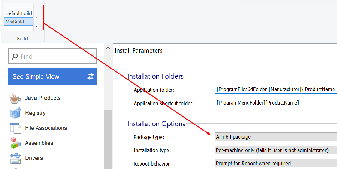

At the moment I added an additional advanced installer project for ARM64 version. The ARM64 project has only one difference: package type is set to Arm64. I'm not happy about that because now I need to do same changes in both versions.
Is it possible to have only one installer project and set Install Parameters/Package type related to some condition?

Catalin wrote: Fri Feb 23, 2024 2:12 pm The only way to overcome this would be through a single AIP and multiple builds, or perhaps multiple projects as you mentioned.
How a separate build could help in this case? It seems the build configuration doesn't have a package type parameter.
Posts: 7794
Re: Does Advanced Installer support ARM64 architecture?
In "Install Parameters" page, you can select a different build and then select a different "Package Type" for each build:
