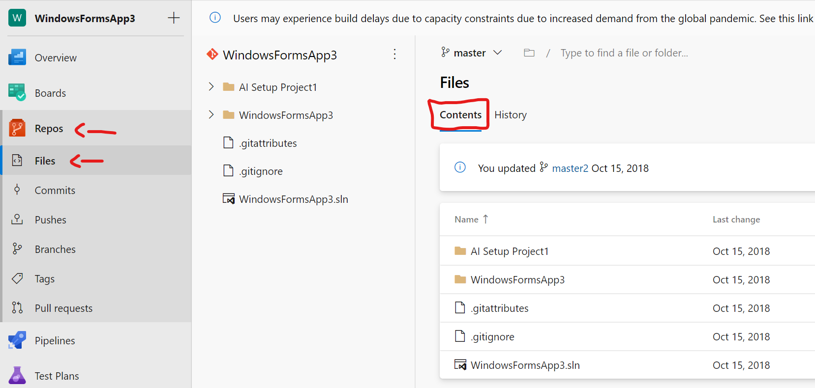

Please make sure, in Azure DevOps, that all of your setup project dependencies are present. You can do so from "Repos" --> "Files" --> "Contents":
