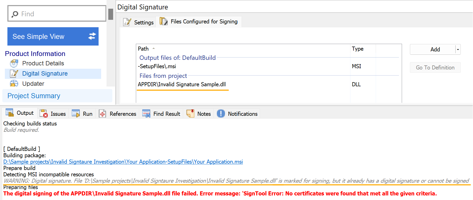

During a project build in Advanced Installer, I received a warning indicating that a certain DLL file was either already signed or had an invalid signature. This was puzzling because, when I checked the file properties in Windows Explorer, the "Digital Signatures" tab was missing, suggesting that the file wasn't signed at all.
AI Build Error.png (100.4 KiB) Viewed 97291 times
Investigation:
This behavior suggested that although Advanced Installer detected some form of signature, it was not valid or in a recognizable format. This discrepancy can occur due to a variety of reasons, such as partial signing, signing interruptions, or even certain types of file corruption.
No tool report the file as signed e.g. Sigcheck , but still signing on that fails.

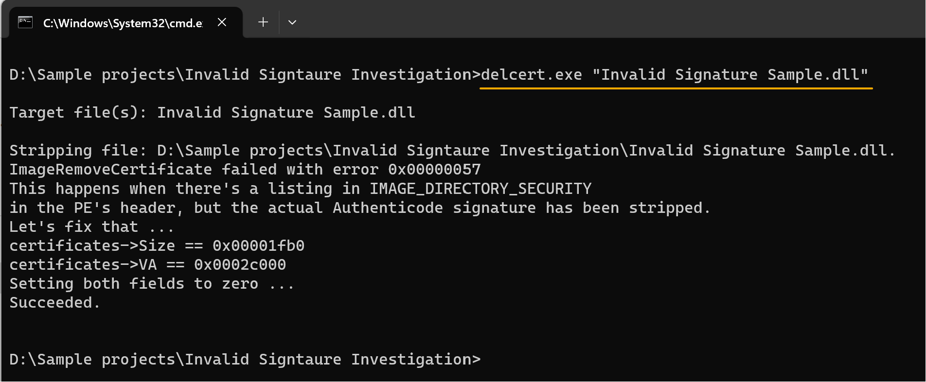

After some research, I discovered a third-party tool that proved to be incredibly useful for this specific issue. The tool is available on XDA Forums, and it's called DelCert (a signature stripping tool). You can find it here.
Please note: Always exercise caution when downloading and using third-party software, ensuring it's from a reputable source to avoid any security risks.
Steps Taken:
  • Using DelCert: I used the DelCert tool to remove the corrupted signature from the file. The process was straightforward and effectively stripped the unrecognized signature, allowing me to proceed without the warning from Advanced Installer.

  • Re-signing in Advanced Installer: With the invalid signature removed, I was then able to successfully sign the DLL during the build operation in Advanced Installer, without encountering any previous warnings.
