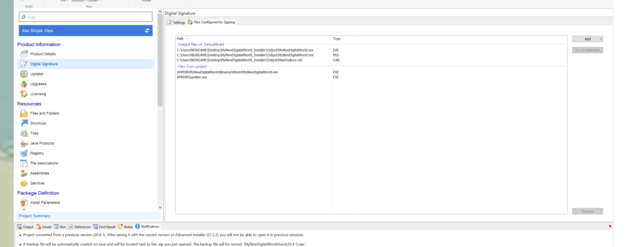

In the "Digital Signature" page --> "Files configured for signing" tab, could you please double check and make sure all the CAB files are signed?
Normally, this scenario should work, I can't really tell why it's not.

on this page i can find my exe,msi and my cab file (but only the main.cab file). the software generate multiple cab files later on building, but i never konw how many cabs are generated and i hope that your software know when there are multiple files to signing they all.
the cab is signed , i tell you when this function make only 1 cab file it work fine but when the size grow and 2 cabs are there in don`t work.
