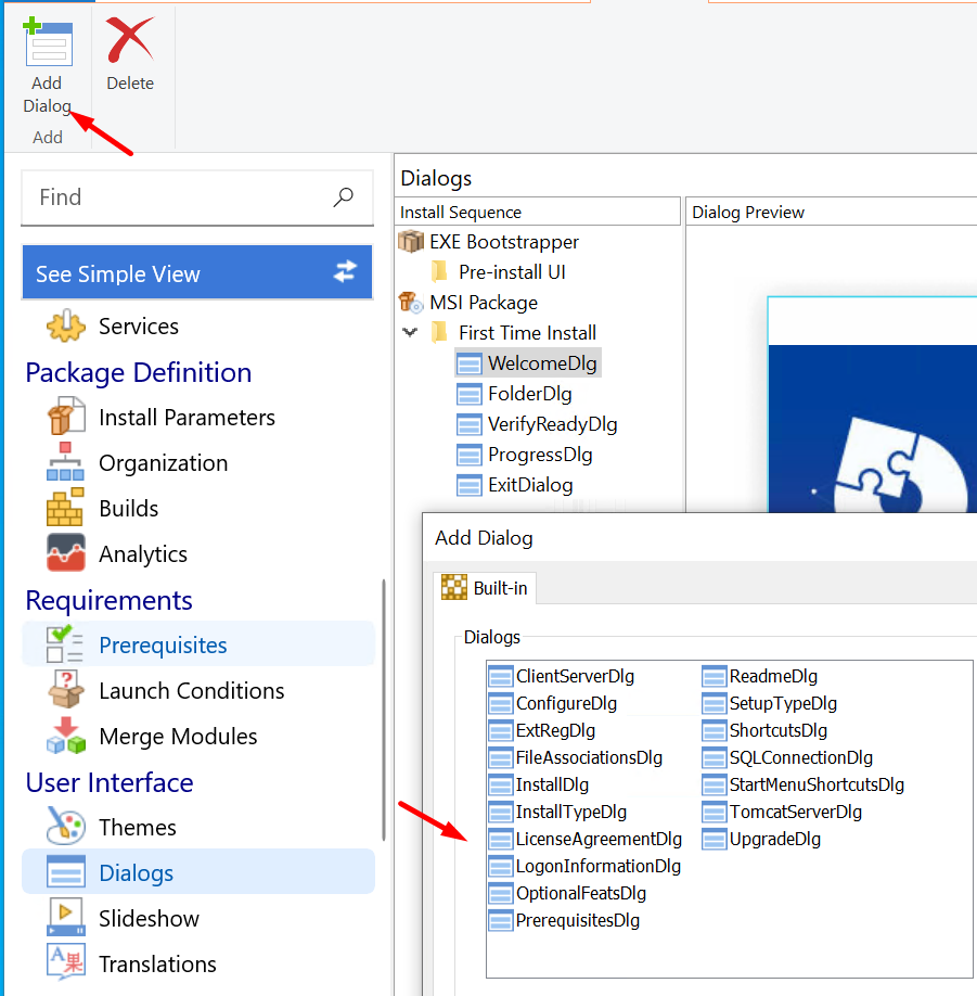

No, the dialog should be available on all suites.
Here's how to proceed in order to add the dialog:
- go to "Dialogs" page
- click on "WelcomeDlg" dialog
- click on the "Add dialog" from the toolbar
Please make sure that your project is Professional and not perhaps Simple.

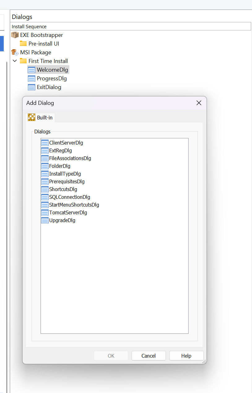

I followed your directions but I'm still not seeing the LicenseAgreementDlg in my options??? I also confirmed that I am using a professional license. See the two attached screenshots.
I started this project as a simple project, then it was automatically changed to Architect at one point. I manually moved it back to Professional because we didn't need any Enterprise/Architect functionality. Could moving the project between versions cause this? Here is the DOCUMENT line from my AIP file.
<DOCUMENT Type="Advanced Installer" CreateVersion="21.6.1" version="21.6.1" Modules="professional" RootPath="." Language="en" Id="{2C1F7A2C-21A7-4468-8165-EAA3CEC1DFD5}">
Thanks in advance!

I FOUND IT!
Looks like the LicenseAgreementDlg is not available when the selected project theme is 'App Installer'. Is this intended? Is there a way to still use the App Installer theme with the dialog I'm looking for?

Glad you managed to find the culprit here.
It is indeed true that the LicenseAgreementDlg dialog is not available for the AppInstaller theme - the reason for this is that AppInstaller theme was created so that the installation process is as simple as possible (less dialogs as possible).
