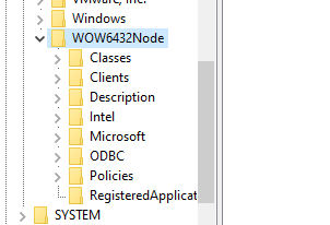

However, that does not seem to be the case here as the registry search should, in fact, be 32-bit - we can see that in the WOW6432Node entry.

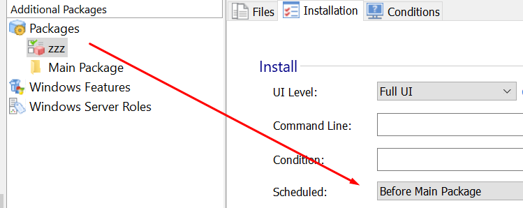

Now, here's how I tested this:
- created a new MSI called zzz.msi
- I added this as a prerequisite in a new project, scheduled to run "before the main package"

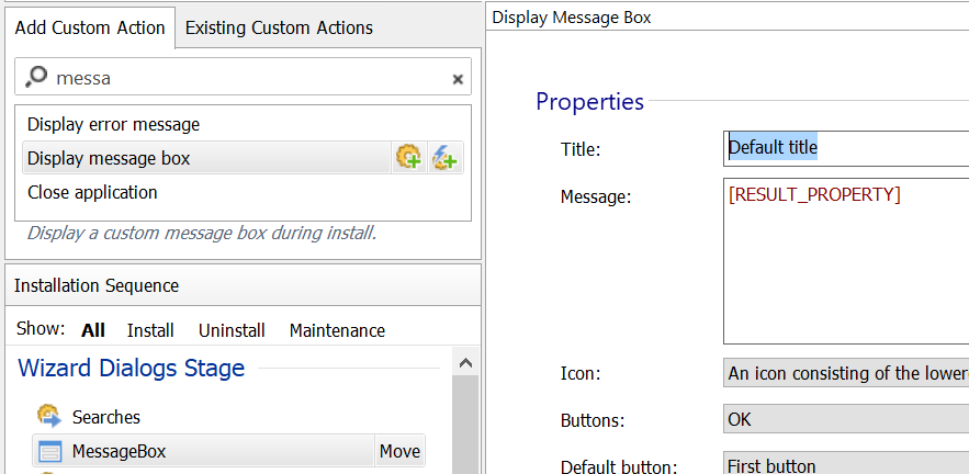

- in the Custom Actions page, I have added a messagebox to make sure this works as expected

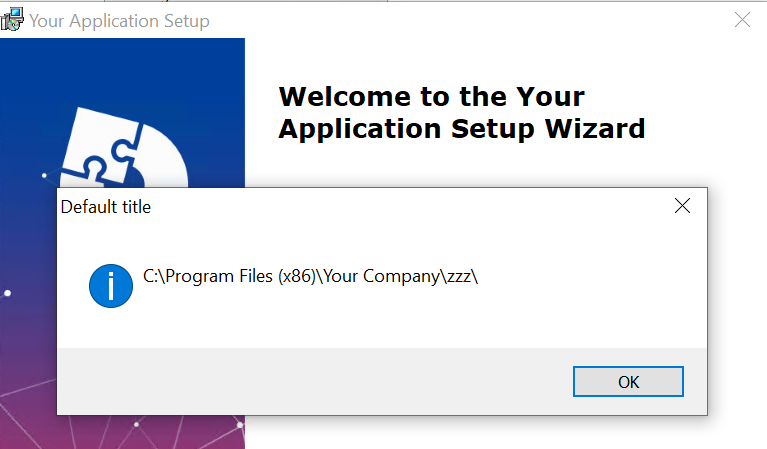

Upon installation, the prerequisite is installed and then when the main package installs, the searches are executed and then the MessageBox prints the expected path:
