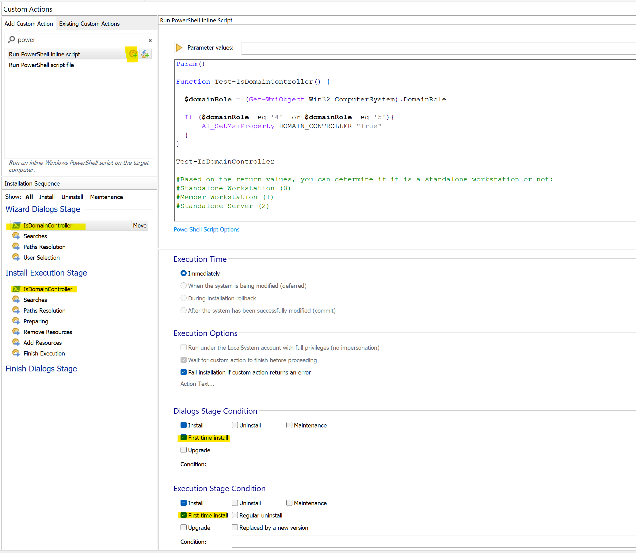

1) Creating a Custom Action to Detect the Domain Controller
For our custom action, we'll utilize a PowerShell script, though you have various options, including C# or C++ DLLs or script custom actions like VBScript. Within the Custom Actions view, we'll add the Run PowerShell Inline script custom action as a custom action with sequence.
The following code snippet checks the target host's domain controller status and sets an installer property accordingly.
Param()
Function Test-IsDomainController() {
	$domainRole = (Get-WmiObject Win32_ComputerSystem).DomainRole
	If ($domainRole -eq '4' -or $domainRole -eq '5'){
			AI_SetMsiProperty DOMAIN_CONTROLLER "True"

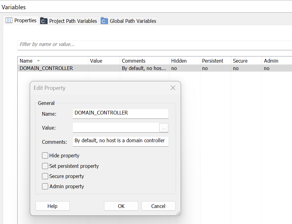

You might want to declare the property in the Properties view:
Properties view.png (42.5 KiB) Viewed 292745 times
Important!
Make sure the Value field is empty!
2) Configure the custom action as below:
CA props.png (175.45 KiB) Viewed 286467 times
Sharing Custom Actions - You can also share a custom action between two standard actions, provided one it is located in the Wizards Dialogs Stage and the other in the Install Execution Stage.
Simply drag a custom action from one stage to the other, while pressing the Shift key. This is useful to ensure the custom action gets executed during a silent installation.
Important!
Make sure the custom action is added before the Searches stage from the dialog sequence.
