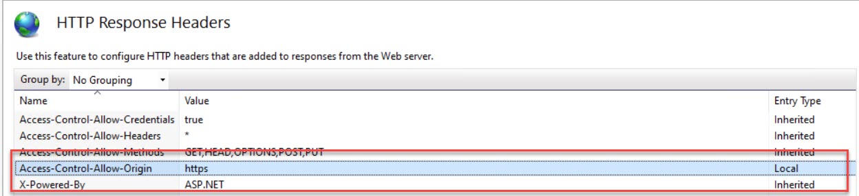

I am setting IIS Config Headers like this:
I specify a default property for [SERVERFQDN] and call a custom action to populate this property, I use that property elsewhere in the installer without issue and it is displayed on my final wizard screen. I can also see in the log that it is being set before this stage of the install, so there's definitely not a problem with the property.
When the installer completes, the ConfigHeader items are all set correctly, except for this one which uses the property:
Any suggestions, it seems to be stripping off the ://[Property] part of the entry.

Hello John,
I have tested this with a sample project and I can indeed confirm the behavior.
There seems to be a problem with the "://" characters.
I have forwarded this to our development team and hopefully this will be fixed in a future version of Advanced Installer. As soon as the fix will be released we will notify you.
We apologize for the inconvenience and appreciate your patience.

Thanks for confirming, I've worked around it with a PowerShell custom action for now.

Hello John,
This has been fixed in version 20.8 of Advanced Installer, released on June 28th, 2023.
