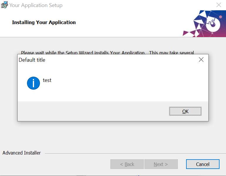

I've tried your suggestion and it can work where the deferred message box can output the correct value passed from command line.
However, it doesn;t work when I try to use the property as the value binding for the DLL argument. This will return empty.
I've to use Inline value for the Value Binding and set it to the correct formatted property.
