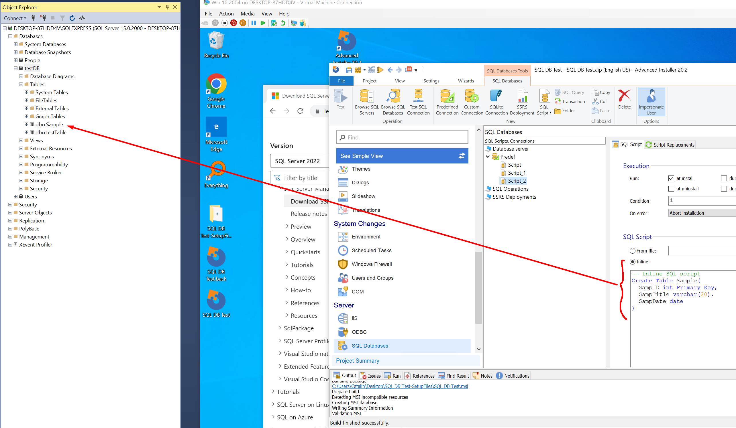

Re: Custom Database Connection To A Separate Server
First of all, thank you very much for your kind words!
As it looks like, our documentation was quite wrong.
Upon further testing your setup with different options, making sure everything is setup as expected, I finally installed SSMS on my VM (I tried to do the connection from the VM to my local machine).
When connecting from VM to my local machine, I noticed that I only needed to provide the computer name, without the instance and the instance would be selected automatically.
After doing so, I have modified the AIP file you have provided me as a sample and voila, everything worked as expected.
The command prompt is from my local machine, whereas the Advanced Installer screen is from the VM.
As you can see, the connection was successful and the table was added.
