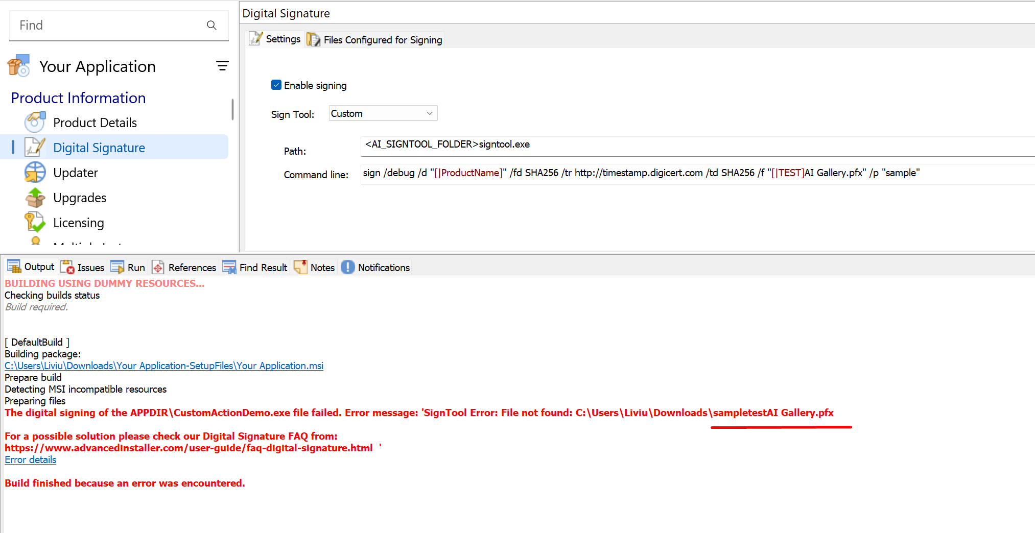

We would like to use a dynamic variable / location in our Signatures tab, a screenshot is attached.
The variable is [|THE_SUPPORTFILES_DIR] which is a proper path.
However during the build we got these errors:
For a possible solution please check our Digital Signature FAQ from:
https://www.advancedinstaller.com/user- ... ature.html '
ERROR: Digital Signature. The digital signing of the 'scriptname' inline PowerShell script failed. Error message: 'Error information: "Error: Store IsDiskFile() failed." (-2147024893/0x80070003)
SignTool Error: An unexpected internal error has occurred.
File "C:\Users\ADO1BU~1.SVC\AppData\Local\Temp\ADV_21148\pss5ADD.ps1" can not be signed!
How can we use a dynamic path there?

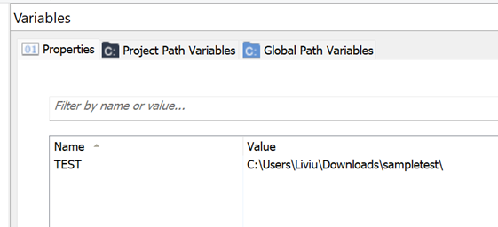

The error "Error: Store IsDiskFile() failed." appears because the certificate path is being resolved incorrectly:
Please make sure that the property used in the signing command points to a folder path that ends with a backslash \.
For example, if you use the property:
its value should be something like:
D:\Therefore Code\
property name.png (30.95 KiB) Viewed 8114 times

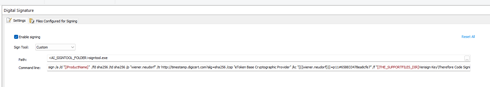

Then, in the SignTool command line, you can reference the certificate like this:
/f "[|THE_SUPPORTFILES_DIR]cert.pfx"
If the folder path does not end with \, the folder name and certificate name will be concatenated, which results in an invalid path.
You can also add the SignTool debug parameter to get more details from the signing operation:
sign /debug
For example:
sign /debug /f "[|THE_SUPPORTFILES_DIR]cert.pfx"
certificate path.png (106.95 KiB) Viewed 8114 times
Please update the property value so the path ends with \, then rebuild the project and check if the signing succeeds.
