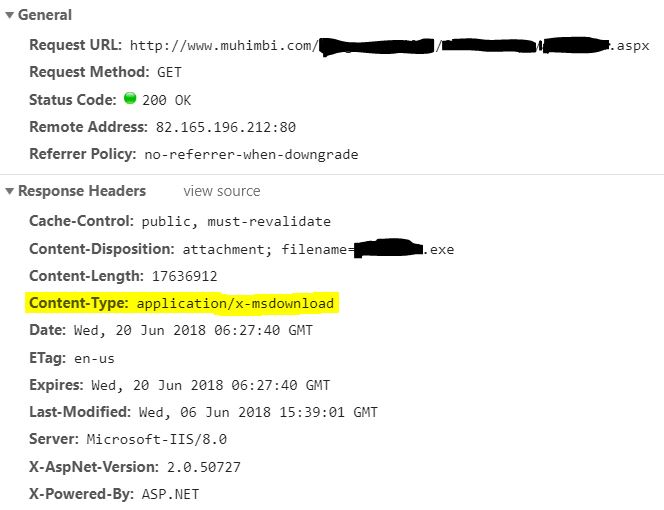

Thank you for your reply. I checked download URL in the browser and it download EXE file. It returns proper MIME type. See Image below:
It we use same URL but with EXE path, it works. But when page is other than EXE then installer tries to open the aspx file using default program.
