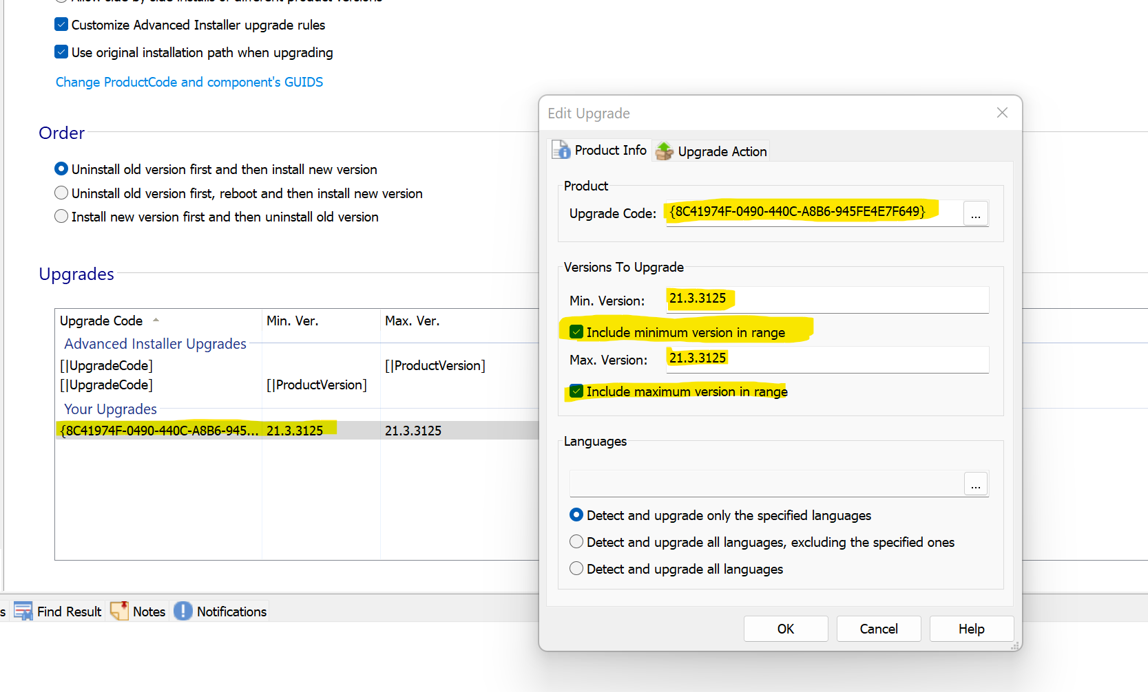

In order to achieve the downgrade, please follow these steps:
1. in the old .AIP project (main project) go to the Upgrades page and add add a new upgrade rule that will uninstall v21.3.3125 of your prerequiste. It looks as it follows:
upgrades page.png (112.87 KiB) Viewed 15012 times
2. now go to the Prerequisites page and move your prerequisite to the Post-install stage.

For older version aip project I have added upgrade rule for kernel msi as you suggested in last reply.
Still it is not downgrading kernel.
Please let me know your observation on the same.

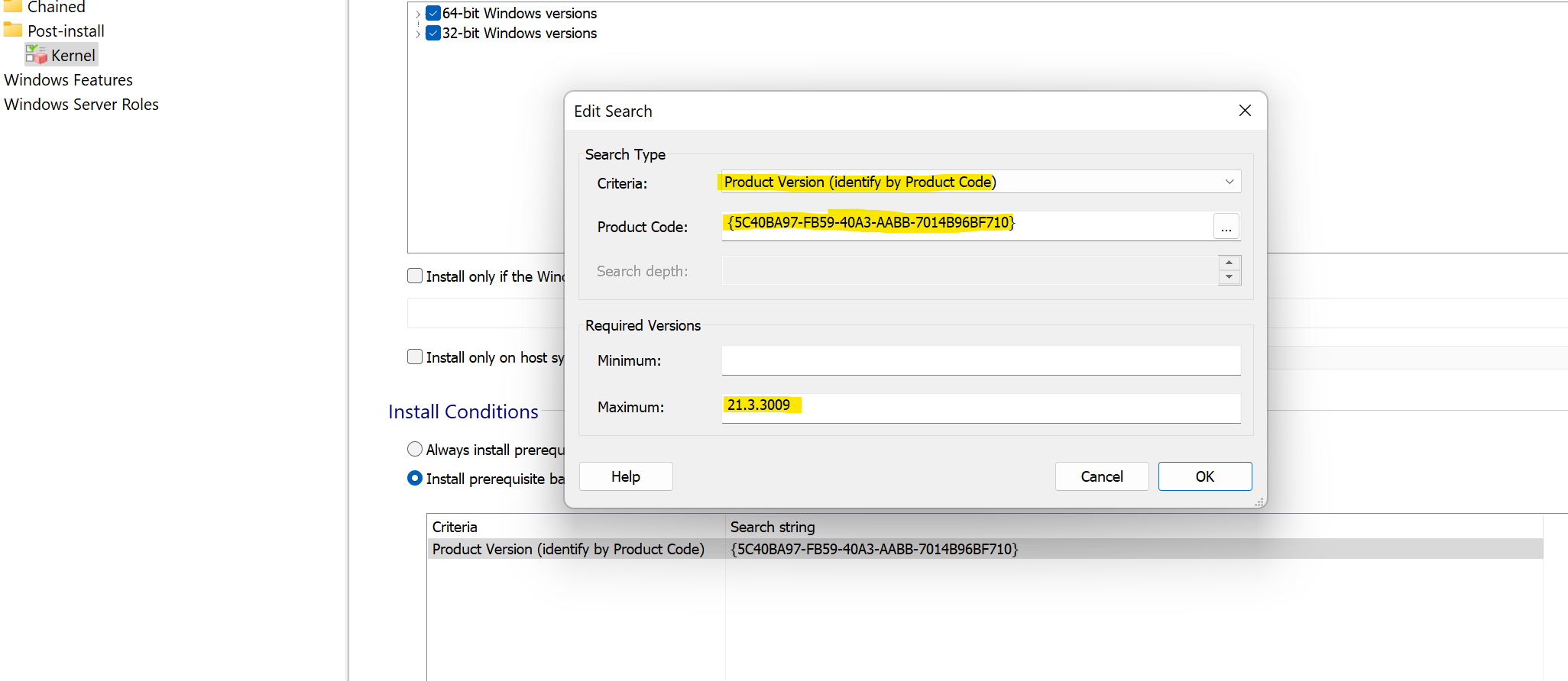

As I already explained, you also need to define a new install condition rule for your prerequisite.
The default condition is as in the above screenshot (from my previous reply) which will be false since a higher version (21.3.3125) is already installed.
Please test it with the "Always install prerequisite" option enabled or find a new install condition for your prerequisite.
For example, you can add the below install condition (in the old project):
prereq condition.png (105.67 KiB) Viewed 14922 times
