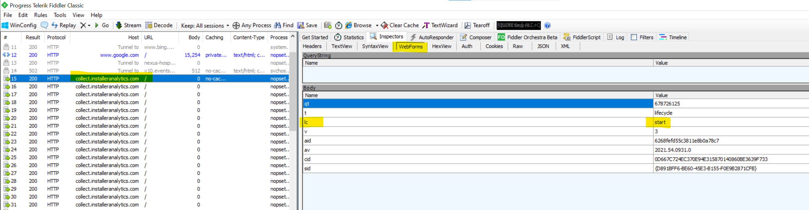

      1. Just install Fiddler and open it.
      2. After that install or uninstall your setup.
      3. Now go back into Fiddler and check the connections to collect.installeranalytics.com
      4. Check the first connection, open the WebForms tab and check to see that "lc" string has the "start" value.

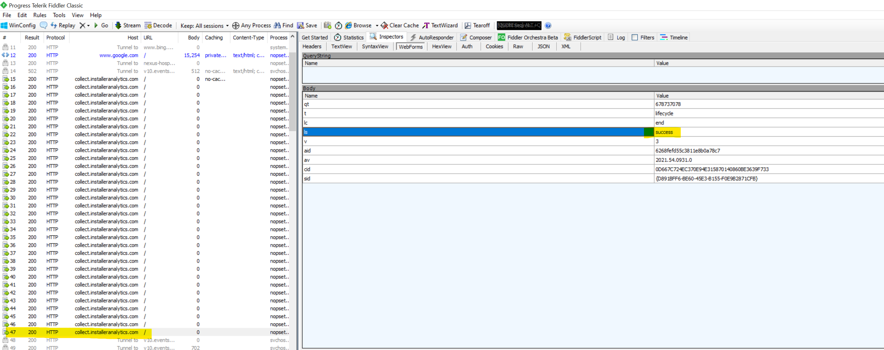

      5. Now check the last result sent to collect.installeranalytics.com which has the "lc" string set to "end". It should have the "ls" string set to "success".
      This will also help to detect possible connection problems.
