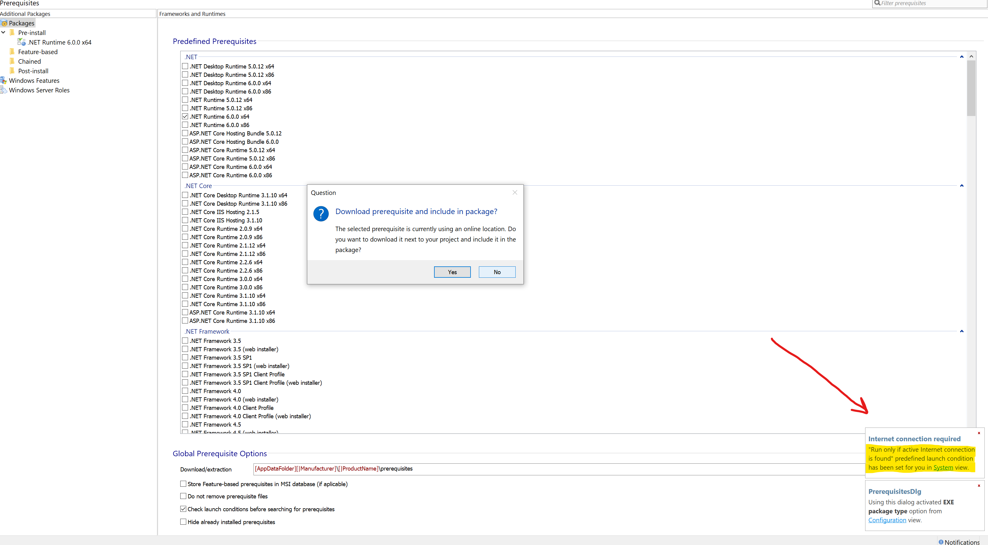

Basically, everytime when you add a prerequisite from our predefined list, the "Run only if active Internet connection is found" option is automatically checked in the "Launch conditions" page.
When that option is automatically checked you will see a notification in "Notifications" tab and in the bottom corner.
internet connection.png (240.46 KiB) Viewed 5660 times
If that is not the case, could you please give me some more details about how to reproduce this issue (perhaps a test-case which I can follow)?

Sorry, I just read the reply in more detail. In my latest installer, I added the .NET 4.8 prerequisite, but I chose to download and include it in my installer rather than download it at install time. I don't recall seeing the notification at the bottom, but I may have missed it.
Posts: 1365
Re: AI re-selects "Require Internet Connection" on me
Also, while I do have prerequisites in my installer, none of them require internet access.
That option is checked automatically just in case the user presses "No" when asked whether he wants to include the prerequisite or not in the setup.
Basically, that option is checked when you add any prerequisite from our "Predefined Prerequisites" list.
To avoid this situation, you can use the "New Package Prerequisite" option, but that means you have to select the desired package from the disk.
Please have a look on the Setup requires Internet conection if I add an prerequisite forum thread which debates the same question.
