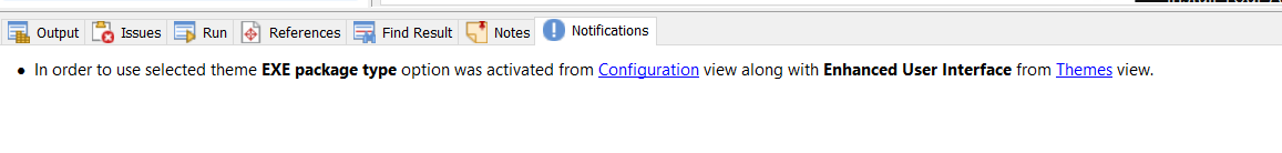

It would be nice to show an explicit warning dialog when this happens, to make things more clear (maybe with a 'Do not show this in the future' checkbox).
A notification is already displayed in the right corner when the package type is automatically changed:
And is also displayed in the Notifications tab:
Notifications tab.png (13.59 KiB) Viewed 4417 times
Also, I have received your email with the files and once I will conclude my investigations, I will follow you up over the email.

Thank you, I missed the popup notification (imho it's easy to miss after the popup has disappeared, but it's definitely there on the Notifications tab :) )
