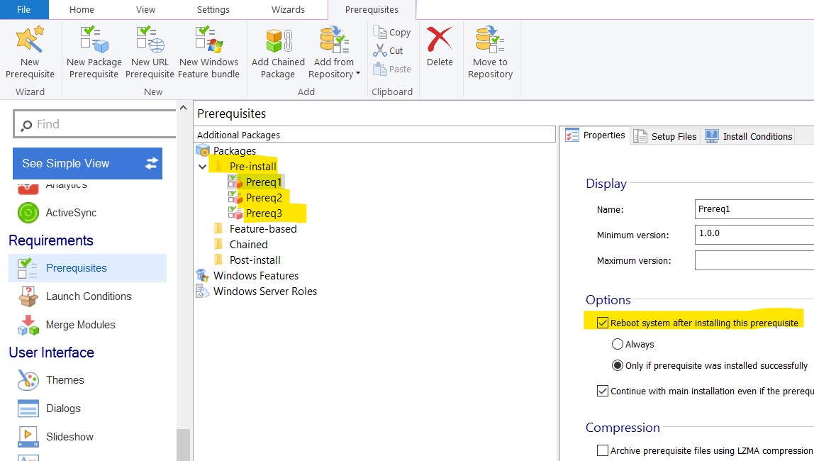

All you need to do is to create a master setup project and add all of the setup packages you want to bundle in the "Prerequisites" view of the master setup project. Then you should just enable the "Reboot system after installing this prerequisite" option for the prerequisite setups you need to trigger a system reboot.

1. create a new "Enterprise" project type (this will be used as the master suite installation that will bundle several packages inside it)
2. go to "Prerequisites" page and add all the setup packages you want to bundle as pre-install prerequisites
3. check the "Reboot system after installing this prerequisite" option for the prerequisites you need to trigger a system reboot
4. build and test the suite installation setup
That's all, now you have built a suite installation setup that will trigger system reboots after the bundled setup installations.
