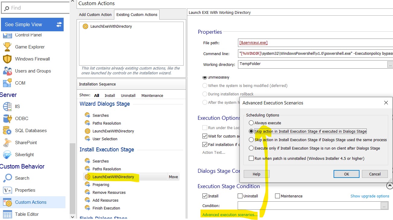

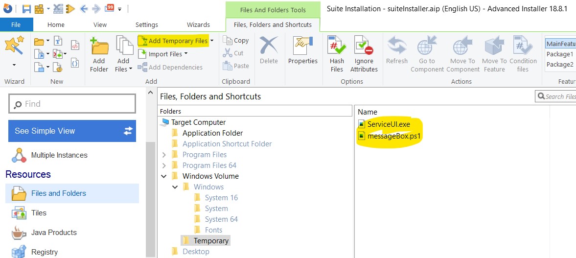

4. go to "Files and Folders" page and add as temporary file the "ServiceUI.exe" tool and a .ps1 script file that displays a message box
5. go to "Custom Actions" page and add a "Launch EXE with working directory" custom action after "Wizard Dialogs Stage -> Paths Resolution" action group; configure the action to launch "ServiceUI.exe" tool
6. select the above custom action and, while keeping the [SHIFT] button pressed, drag and drop it under "Install Execution Stage -> Paths Resolution" action group; this way the custom action will be shared by both installation stages (UI and install execution)
7. click on "Advanced execution scenarios..." hyperlink and select the "Skip action in Install Execution Stage if executed in Dialogs Stage" option
