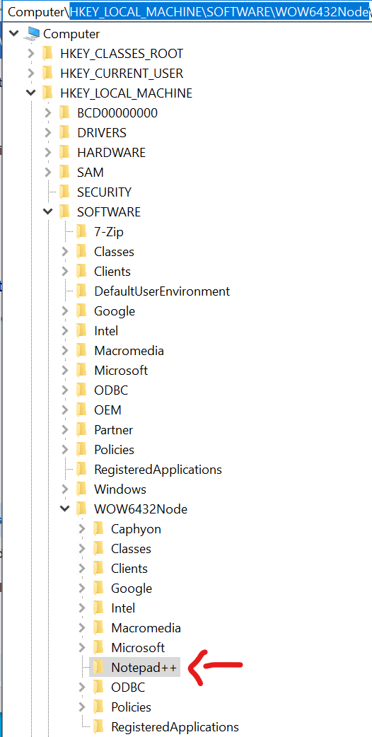

In my case, I have installed a 32-bit version of Notepad++ on my 64-bit machine, therefore the location I am looking in is the following:
HKEY_LOCAL_MACHINE\SOFTWARE\WOW6432Node
Here is how that looks on my machine:
As we can see, we are pretty lucky because we already found a key related to "Notepad++".

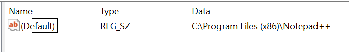

The key contains the following entry:
That looks to be the installation folder of Notepad++.
As we can see, this key is unique to Notepad++ and is present on the machine only if the product is installed.
If we uninstall Notepad++ and refresh the Registry Editor, we can see that the key is no longer there:

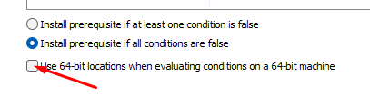

If you have a 32-bit main setup and a 64-bit prerequisite (that will not write its' settings under WOW6432Node), it would be useful to avoid the redirection by checking the "Use 64-bit location when evaluating condition on a 64-bit machine" option from under "Install Conditions" section.
