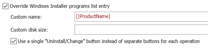

I just saw that -in case of uninstalling the program the msiexec is called with the paramter /i. Shouldn't it be /x ?? I manually tried to do this with the /x param and it worked just fine... Why is windows calling the msiexec with /i instead of /x and how can i modify that from within Advanced installer?
The setup is launched with the /i parameter because you have the Use a single "Uninstall/Change" button instead of separate buttons for each operation option enabled in the Product Details view:
ProductDetails view.PNG (6.93 KiB) Viewed 39958 times
So, having it with the /i is correct.
