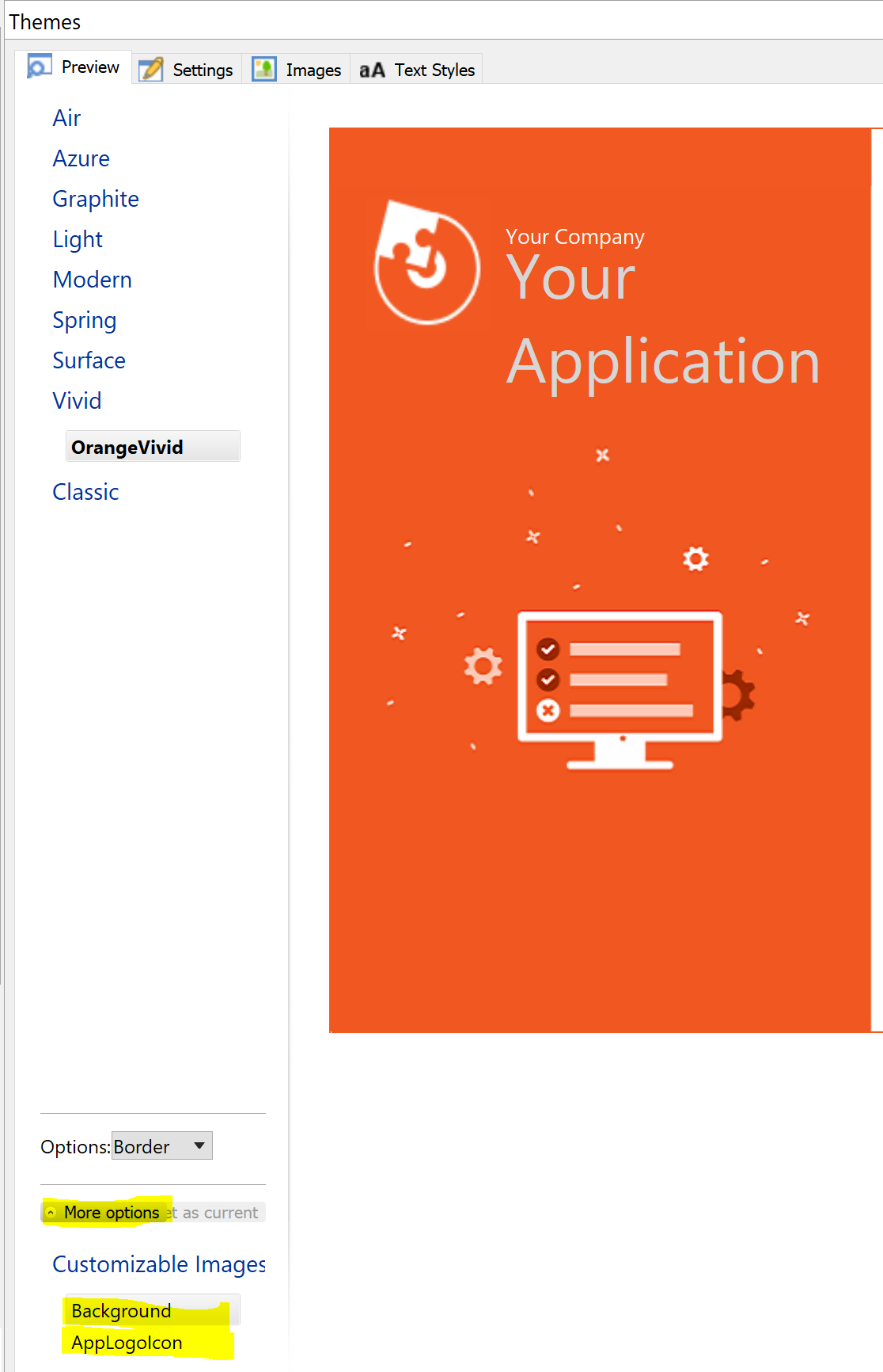

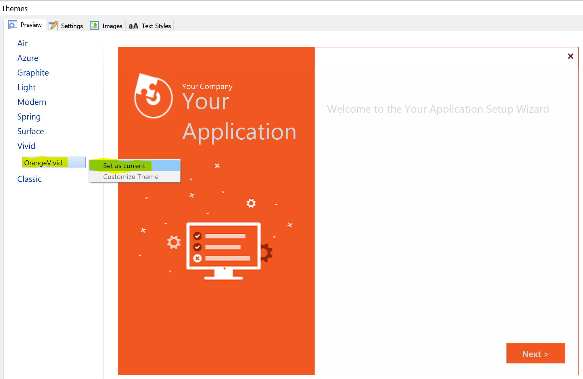

Select theme and variation
Select the theme and variation that you want to be used as a starting point for your custom theme. In this case, we'll start a new variation (blue) variation for the Vivid theme:
Select variation.PNG (123.87 KiB) Viewed 282187 times
Add background image and logo
The next step would be to provide the logo and the background image that will be used by the theme:
Background & Logo.PNG (117.65 KiB) Viewed 282187 times

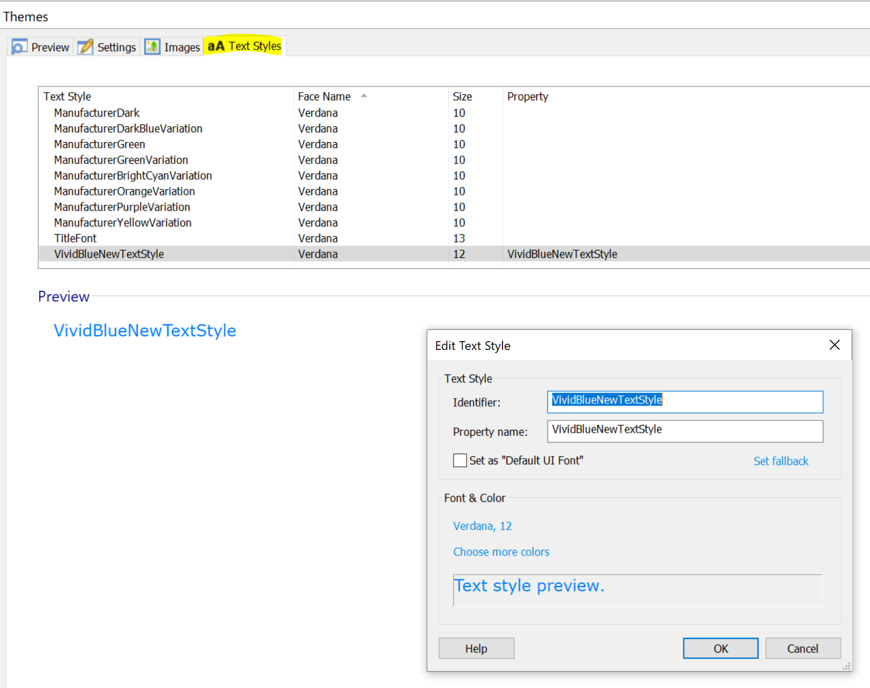

Define custom text style to be used by controls
Create custom text style to be used by the controls:
text style.PNG (229.29 KiB) Viewed 282187 times

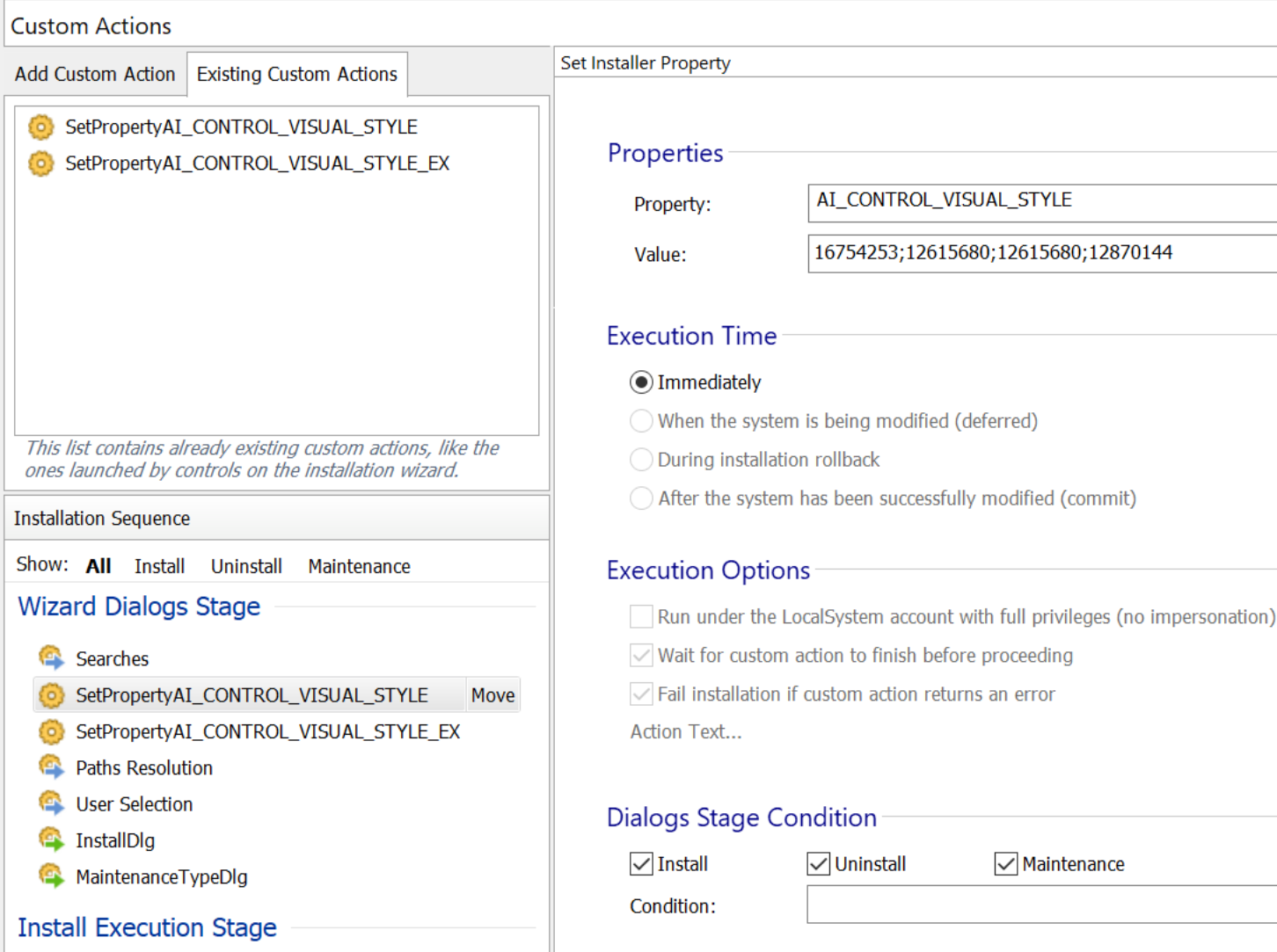

Edit the path edit control with custom variation. The same applies for background of the ScrollableText /Eula control or QuickSelectionTree.
In order to achieve this you can set the "AI_CONTROL_VISUAL_STYLE" property to something like this:
  • decimalBackgroundColor;decimalOverBackgroundColor;decimalBorderColor;decimalOverBorderColor
where the above components value represent a decimal color value.
You can add a "Set installer property" custom action with sequence before "Wizard Dialogs Stage -> Searches" action group like this:
  • Property: AI_CONTROL_VISUAL_STYLE
    Formatted: 16754253;12615680;12615680;12870144
AI_CONTROL_VISUAL_STYLE_EX is used when the control is disabled.
In order to find the related decimal color value you can proceed like this:
- Go to "Themes -> Text Styles" tab and add a new text style with a desired color(e.g. MyStyleColor).
- Go to "Table Editor" page, select "TextStyle" table and search for the above text style decimal color value.

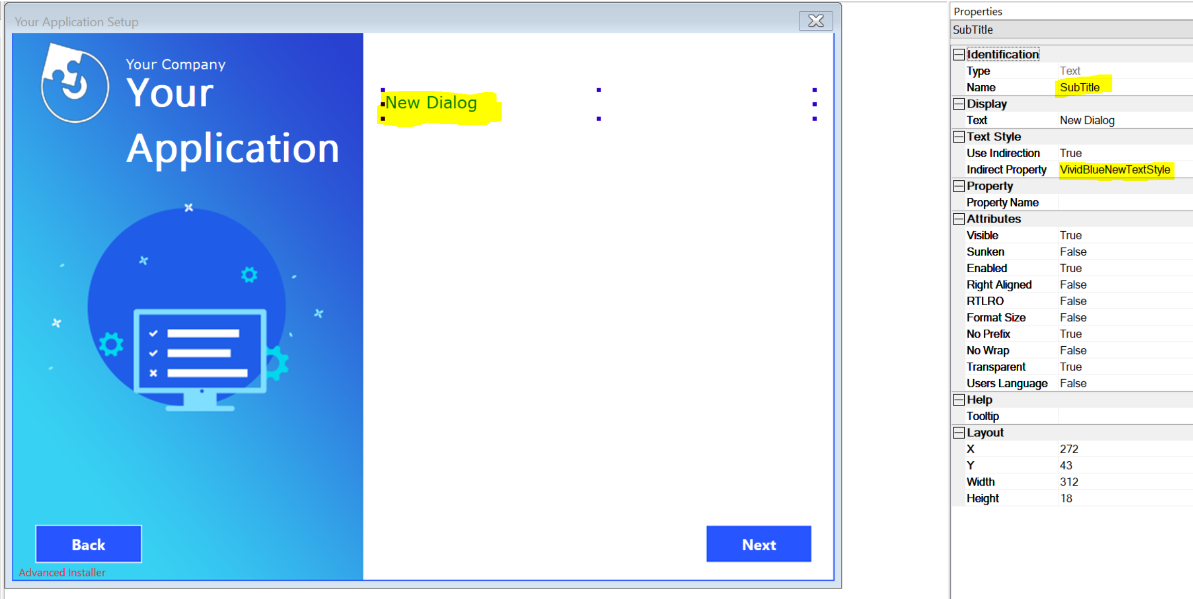

Change text style for controls
Now, you can go in the Dialogs view and edit the dialogs acordingly with your design, add or remove existing controls or change the text style used by a control:
