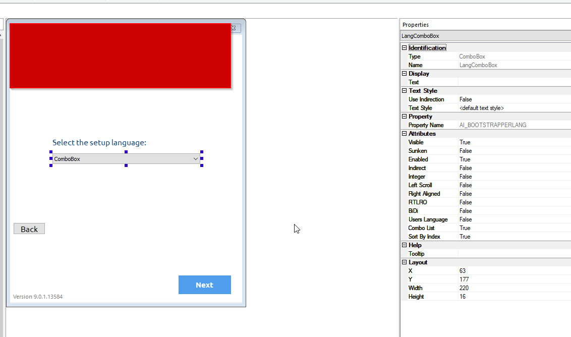

I was trying to change some fonts for a project using the "Surface" theme.
For example, I edited the font "Manufacturer" (Property "ManufacturerFont").
However, these modifications only apply if I go to the Dialogs page, select the text field and then change "Use Indirection" to "false". As long as it is true, the changes won't apply.
This means for me that I have to go to every single install sequence page and change the text styles of every single text box for all changes to apply.
I guess, I am doing this wrong because that can't be the expected behavior.

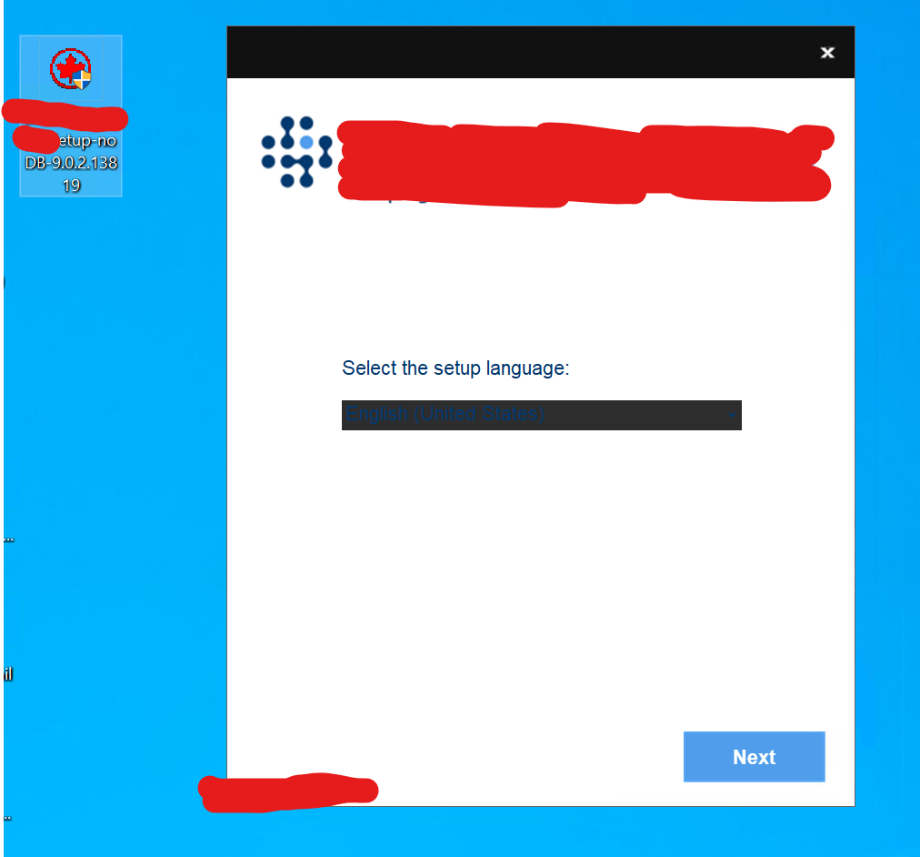

We just realized that when we set a background image, also indirection is not used correctly. This does not only mean that we would have to set the picture individually for every dialog page, but also the drop down menus are displayed completely random.
For this screenshot we selected the background explicitly. For every other page, the background is not taken and is black.
This way, we are not able to publish our software, so I really need you to fix this asap!

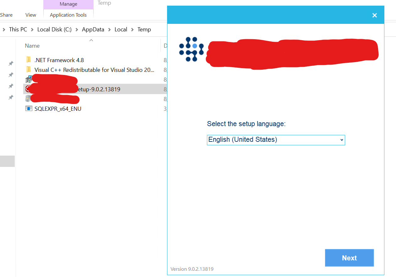

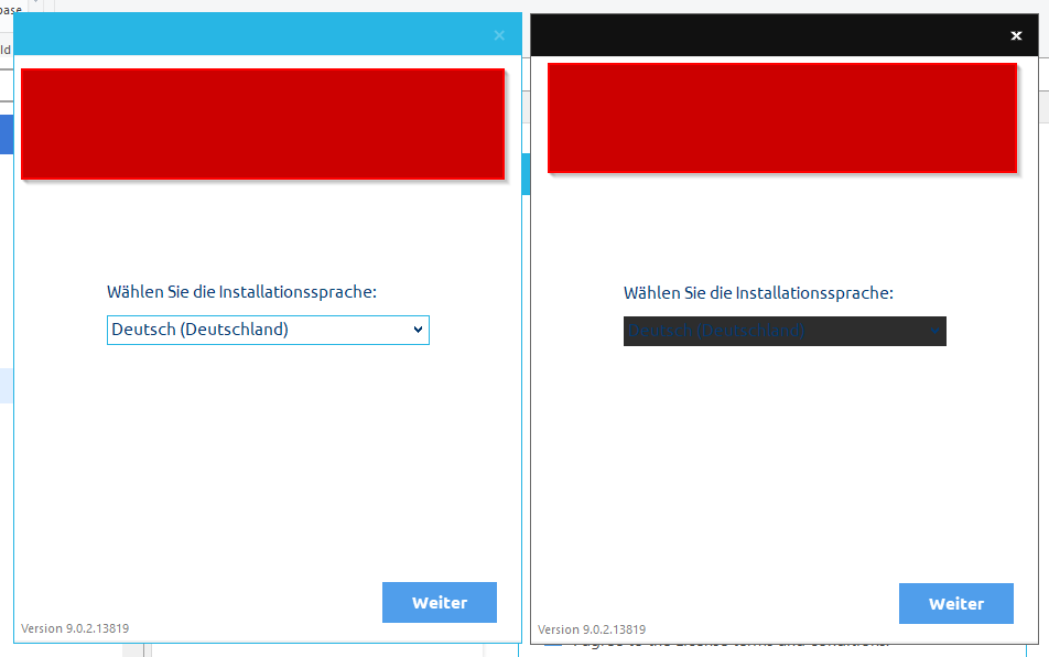

i will send you the AIP file of my project to have a look at it. In the meantime, I continued my research. It looks like if I use the "Test Installation UI" option, everything from the background perspective is rendering as expected. When I actually build the setup and run it, the colors of the "BrightCyanSurface" theme are not taken and the borders are black and the background of the dropdown etc. as well.
Left, you see how it looks using the "Test Installation UI" option, right you see the actual build (both done on the same machine).
It somehow looks like the internal background is gone missing (our selected background image is displayed correctly).

are you sure, you actually built the setup or used the "Test Installation UI" option?
I built the setup with different machines and used different machines for running the setup. The result is always the same: The background is black.

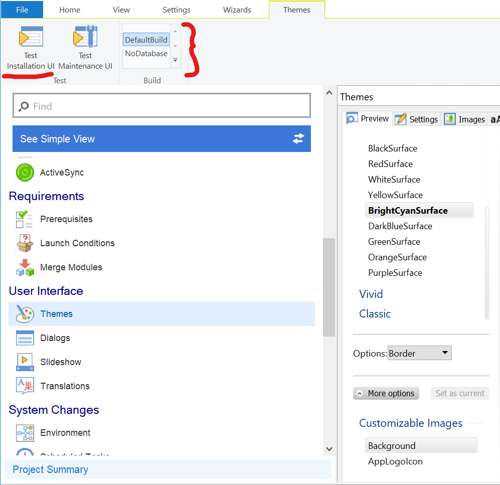

First of all, there are two builds in your project:
For each build, you have a different theme:
- one has the BrightCyanSurface theme
- the other one (the NoDatabase one) has the BlackSurface theme

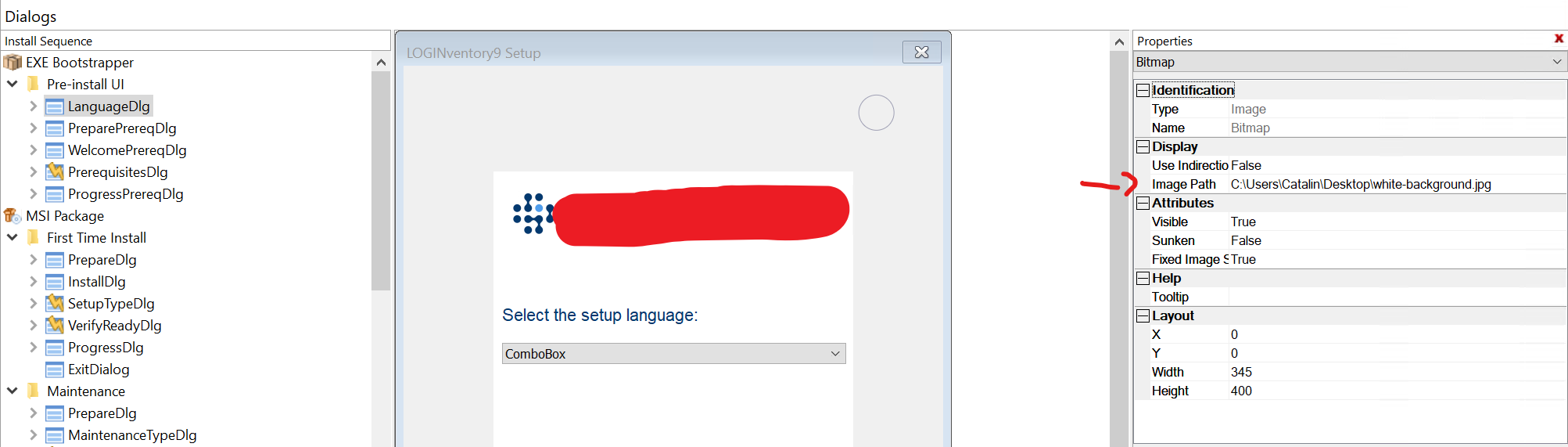

For both dialogs, on the "LanguageDlg" dialog, you have pointed to the same background, the white-background.jpg
Most likely, after building the setup, you are launching the "NoDatabase" build, resulting in the BlackSurface theme with the white background.
If you would have launched the build that has the BrightCyanSurface theme (the "DefaultBuild"), you should get the behavior you expect:
Most likely, when you have used the "Test installation UI" option, you have used it for the DefaultBuild build, while afterwards launching the NoDatabase build.

you were totally right. I didn't know that you could change the theme per build.
Thank you very much for your help!

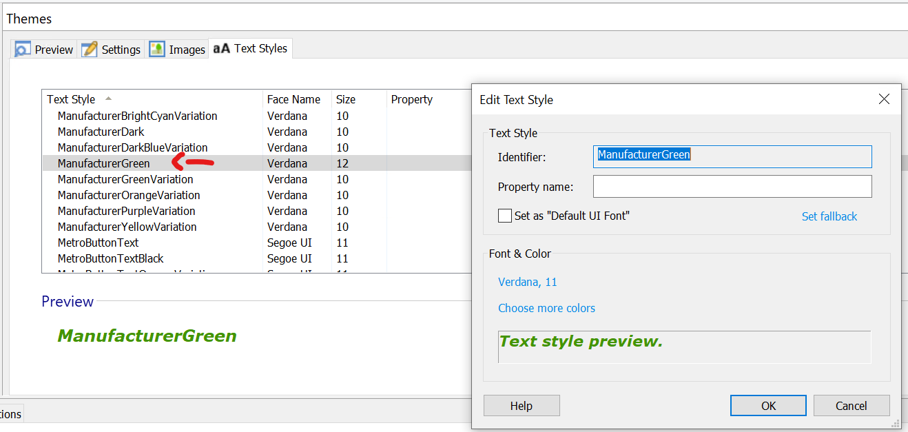

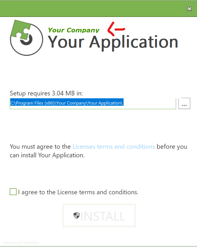

Regarding the font issue, after further discussing this with our development team, it looks like the behavior is normal.
The Manufacturer font is changed for variations using the Fallback support.
In order to change the font for white lets say, you need to change the ManufacturerGreen font (basically what the color is for it. In our case, for the WhiteSurface theme, it is green), e.g.:
This should result in the following when launching the setup:
