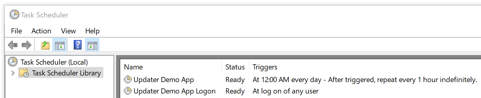

The updates are installed silently, the check for updates is happening at user logon, the check being triggered by a scheduled task configured to run under the System account. This way, the application can be updated under any user account from the machine, it doesn't matter if the user has admin privileges or not.
Also, there is another task that is being triggered hourly, indefinitely. So, multiple scenario can be implemented just by adding multiple tasks with different startup type.

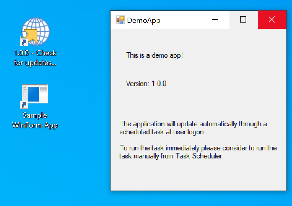

How to test the sample app
To test the sample app, just install the Demo App.exe from the v1 folder: .\v1\Demo App-SetupFiles.
After the installation, there should be 2 shortcuts created on the desktop:
  • 1.0.0 - Check for updates Demo App shortcut, this is a shortcut to the Updater so that you can even manually check for updates. Also, it contains version in its name to be easier to track installation of the updates
  • Sample WinForm App which is a shortcut to the sample app

To test the updates installation, just open the Task Scheduler and find any of the below tasks that can trigger the Updater to check for updates and automatically install them in case any update is found.
Basically, just need to pass the command line for the updater:
/silentall -nogui -nofreqcheck
The updates should be installed automatically, no UI of the Updater or from the installer should be displayed during upgrade process. Also, the updates should be installed without any UAC prompt.
