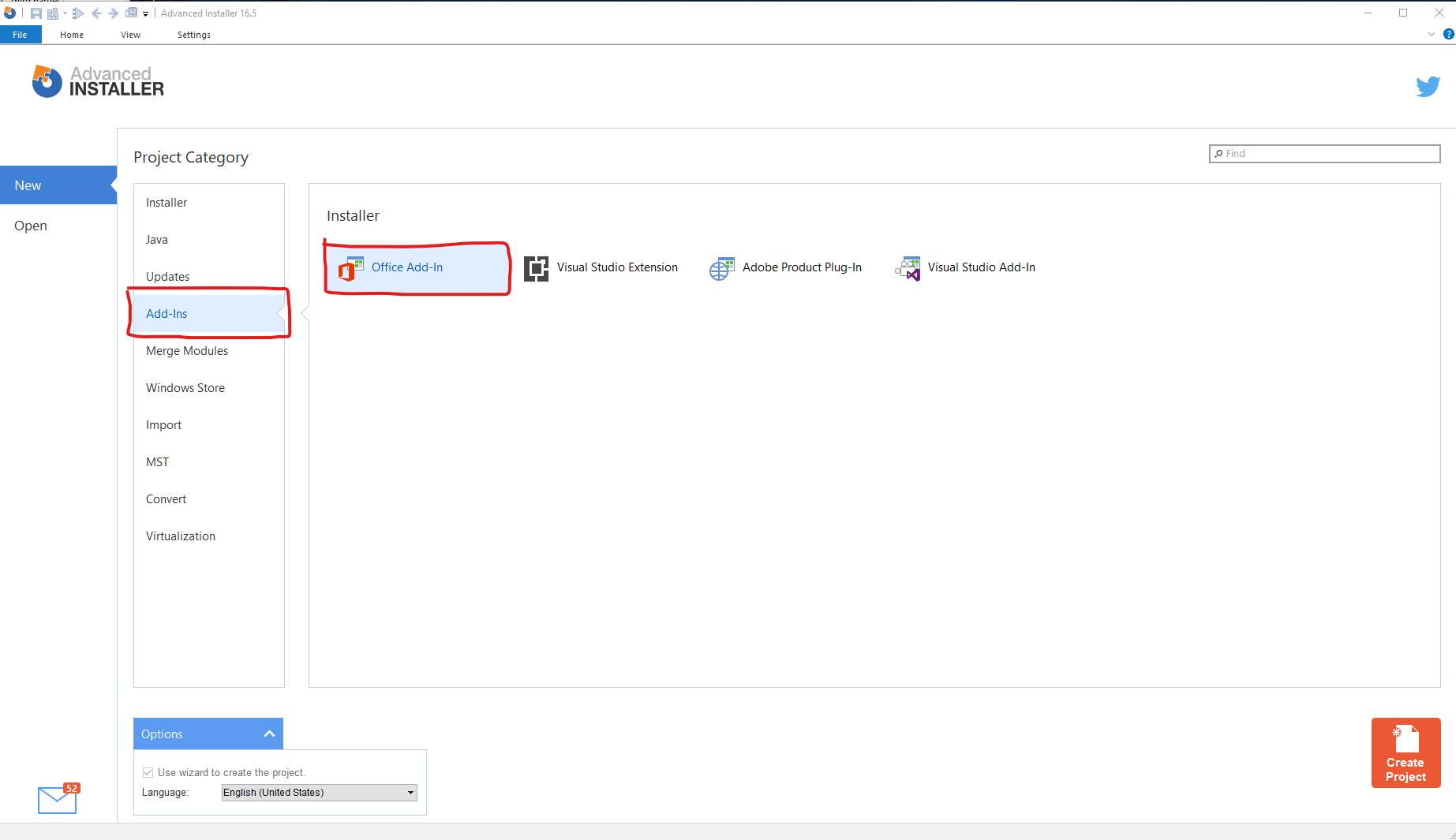

- First thing you have to do is to open Advanced Installer, go to "Add-Ins" tab from "Project Category" and double click on the "Office Add-In". This will spawn a wizard which will guide you through the rest of the process.

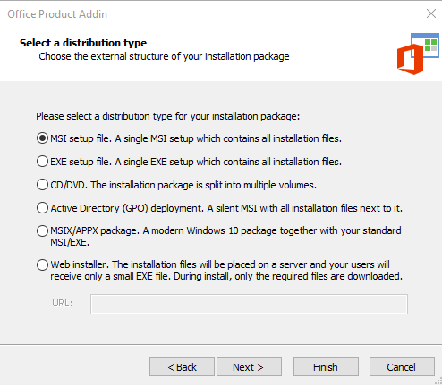

- The next step will be choosing the package type (e.g. MSI, EXE, etc.)

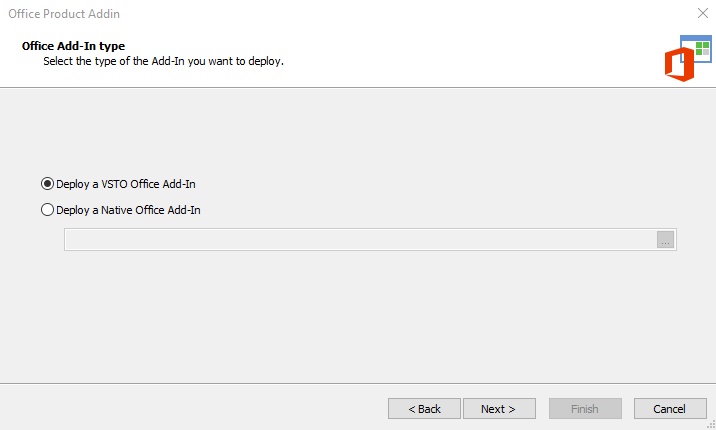

- The next step will be choosing the Add-In type we want to deploy. For this, I have chosen the "Deploy a VSTO Office Add-In" (since the Add-in was created using Visual Studio Tools for Office (VSTO))

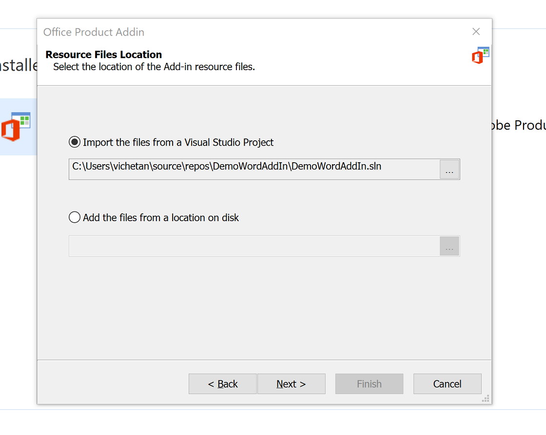

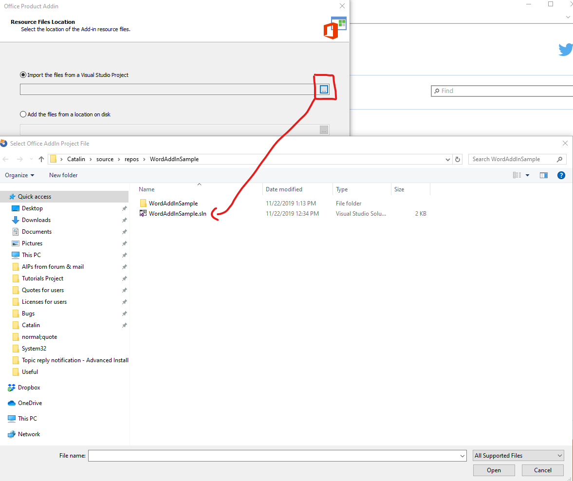

- The next step will be selecting the location of the Add-In resources. In my case, I will be importing my files from the Visual Studio Solution

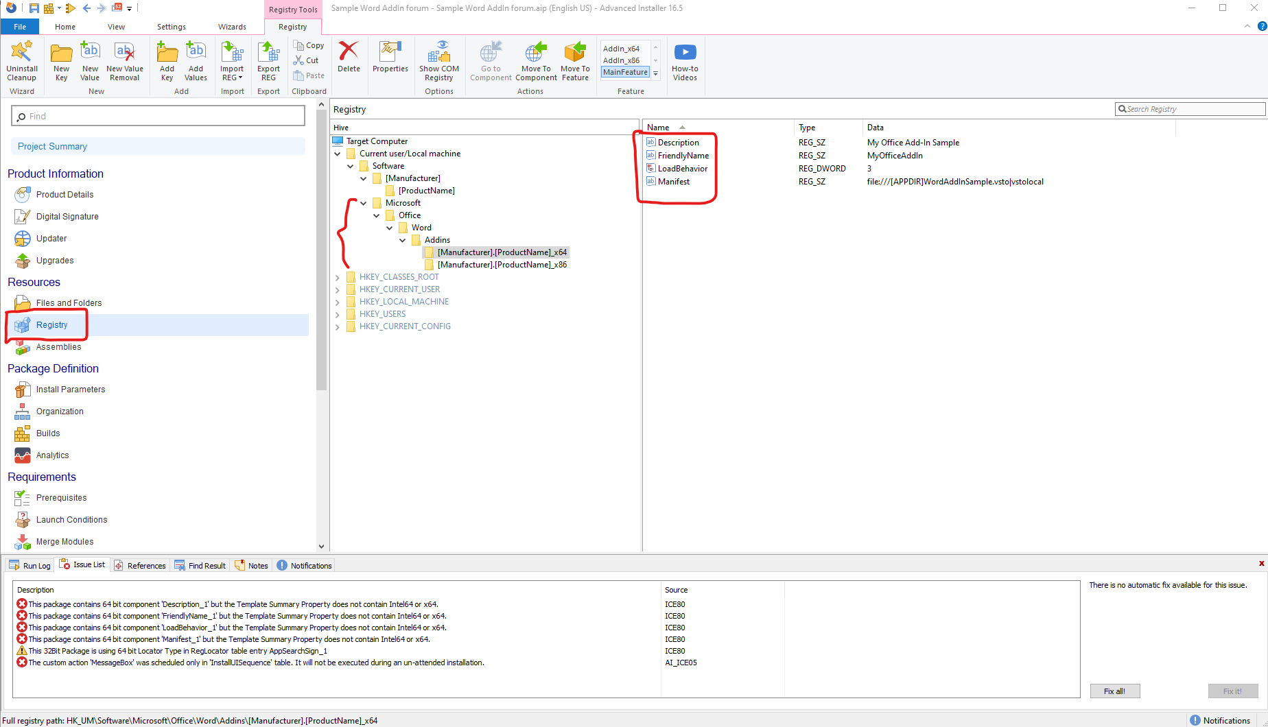

Basically, what should be noted here is the fact that only the registry entries are different. Upon completing the Office Add-In wizard, if we go to "Registry" page, we can notice the fact that, beside the default registry entries that are automatically added in every Advanced Installer project, few more entries are added that are specific to Office Add-Ins.
In the above screenshot, you can notice the following values: Description, FriendlyName, LoadBehavior and Manifest which are located under:
HKLM:\Software\Microsoft\Office\Word\AddIns\[Manufacturer].[ProductName]
The above key is present when going into the "Registry" page. However, in my screenshot, you will see two keys:[Manufacturer].[ProductName]_x86 and [Manufacturer].[ProductName]_x64. Basically, what I have done here is duplicating the registry entry and simply changing their names. In order to copy the key, please select it --> press CTRL+C --> select the "AddIns" key and press CTRL+V. After doing so, you can select each key and press F2 to rename it.

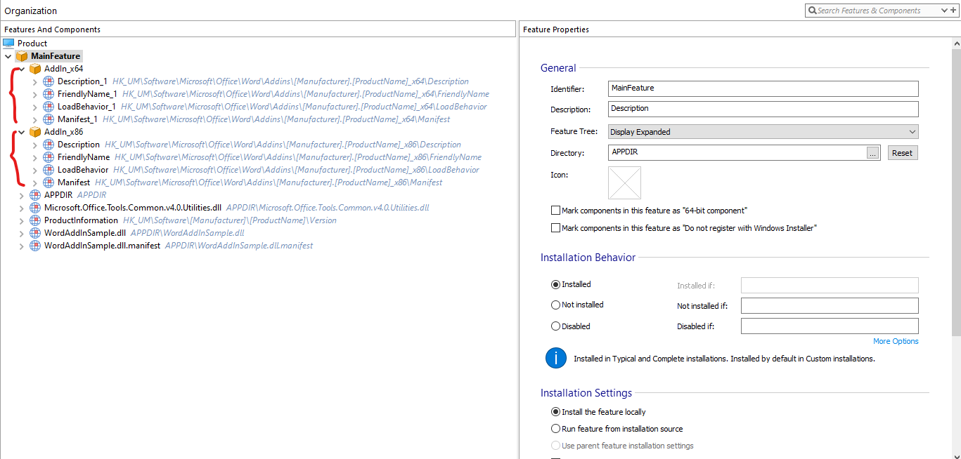

Every registry value from the "Registry" page is reflected into the "Organization" page as a component. Due to the fact that we have duplicated the key, we will now have 8 distinct components in "Organization" page, such as:
1. Description, respectively Description_1
2. FriendlyName, respectively FriendlyName_1
3. LoadBehavior, respectively LoadBehavior_1
4. Manifest, respectively Manifest_1

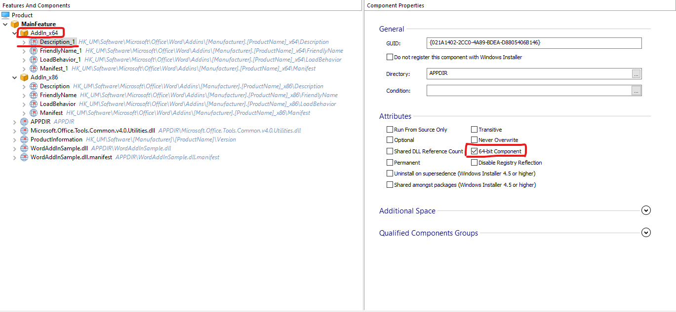

Here, in order to make an easier to follow UI, I have created, under the MainFeature feature, two subfeatures as it follows: AddIn_x86 and AddIn_x64. In order to create a sub feature, please click on MainFeature feature --> "New Feature"
Now, what I would like to do here is to move the earlier specified components to their appropriate features:
a) please move the following components: Description, FriendlyName, LoadBehavior and Manifest to the "AddIn_x86" feature. In order to move a component to another feature, simply select the component and then drag and drop it to the appropriate feature.
b) please move the following components: Description_1, FriendlyName_1, LoadBehavior_1 and Manifest_1 to the "Addin_X64" feature.
In the end, it should look like this:
Important: Please select each component from the "Addin_x64" feature and check the "64-bit Component" option for it
