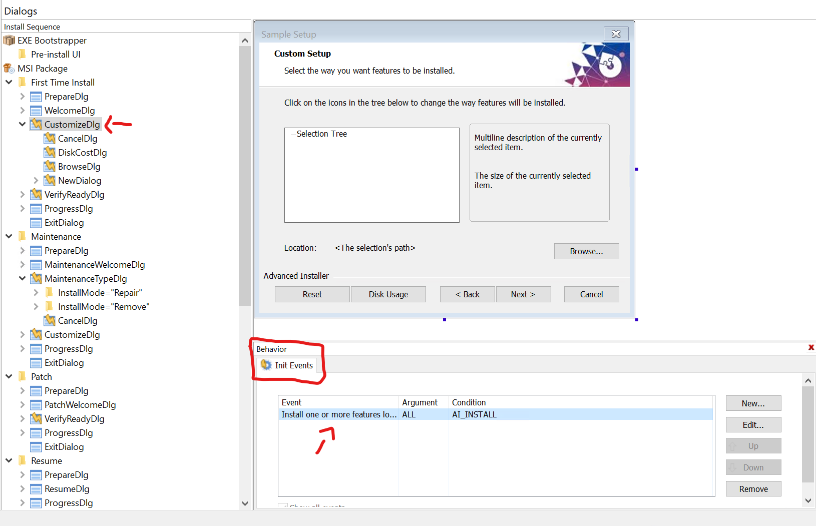

Posts: 7794
Re: Reset Button In CustomizeDlg
Hello Emmanuel,
Thank you for the provided project.
From what I can see, you did not quite implement the steps I have given above at all.
Below you can find a screenshot of the "Init Event" I have mentioned in my previous mail that did not exist in the sample project (I have added it myself):
Please read my previous thread again and try to implement the steps.
Also, please let me know if anything is not clear enough.
Emmanuel
