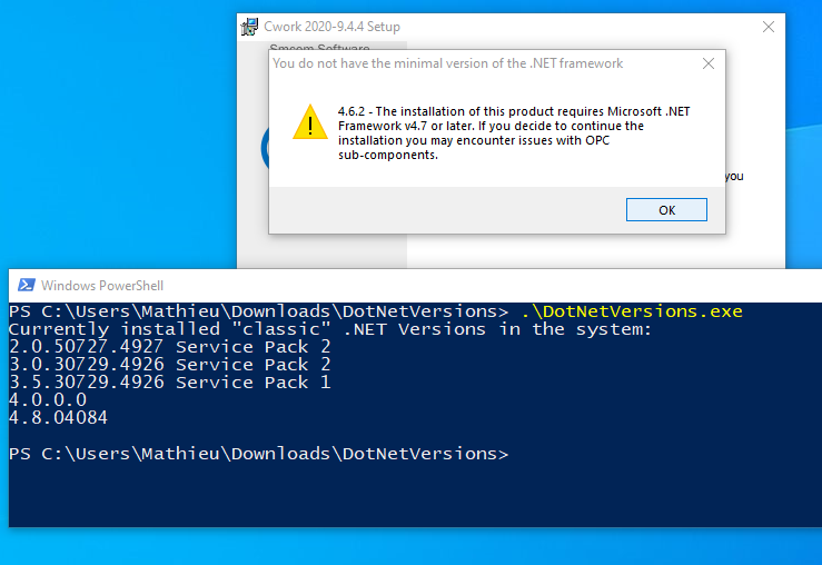

I'm having issues with a custom action. That custom action simply prompt the user if the .net version detected is not equal or superior to the .net version my software needs.
I'm aware that I can use launch conditions to re-create that behavior but i'd rather leave the user the option to dismiss the message and go on with the installation because he might not be using the subset of my solution that actually requires the said .net version.

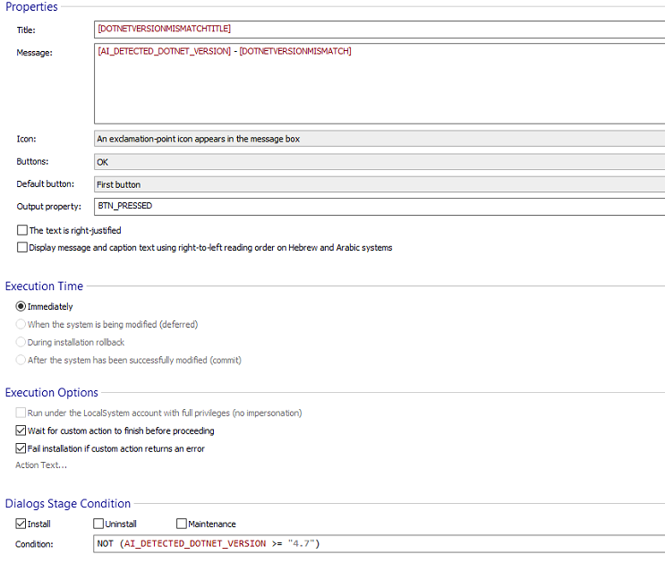

In any case, here is what my lauch condition look like :
and here is the result on a target machine :
As you can see, AI_DETECTED_DOTNET_VERSION value is 4.6.2 here but the command line tool (available here : https://github.com/jmalarcon/DotNetVersions) shows me i have a 4.8 version of .net installed thus making my custom action trigger unnecessarily.
