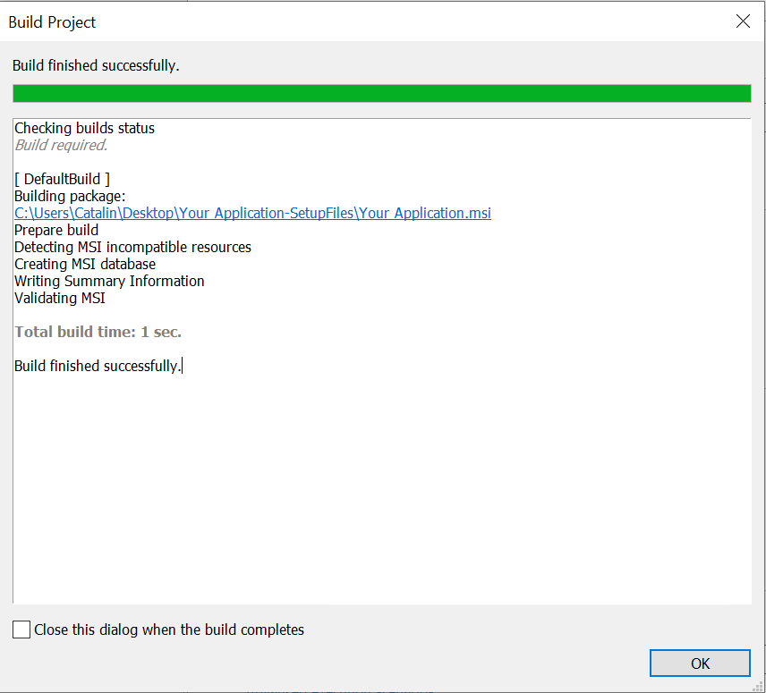

If my above assumtion is right, you should be able to see the "Build" dialog (where the steps of the build process are displayed), e.g.:
Normally, if an error occurs, here is the place to see it. Does this dialog not appear? Or does the dialog appear, but it displays no error and then suddenly closes?
