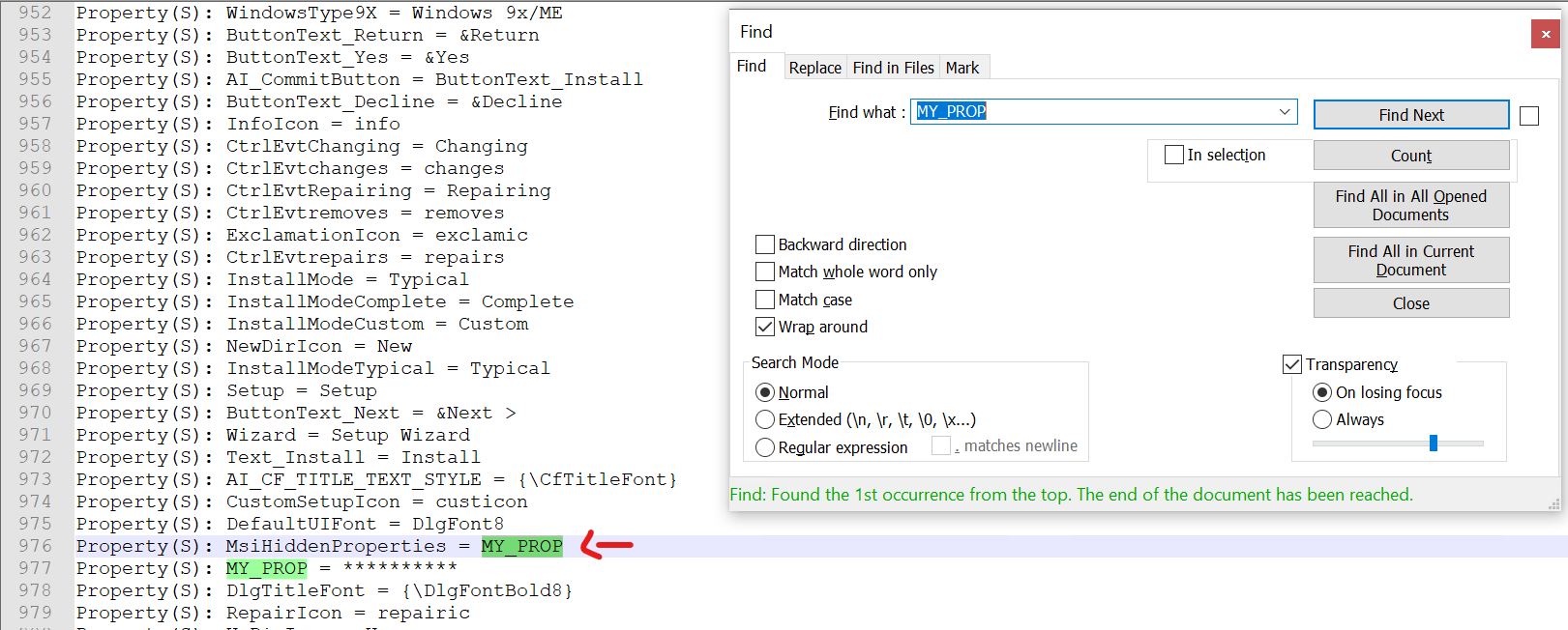

It sounds like I can add the "MsiHiddenProperties" property to my project and add any properties I want to hide to it
When using the "Hide property" attribute for one of your properties, this is exactly what happens. You can see this by searching for your property in the log file:
In addition to this, I have also tested the scenario where the property is empty with a comment. From what I could see, the property is only specified when it is added to the MsiHiddenProperties property, just as when it has a value.

In the attached project, using the command in the comment, I do not see "MsiHiddenProperties" in the log, and the password for the hidden property is displayed:
I'm using Advanced Installer 16.7... not sure if that matters?
