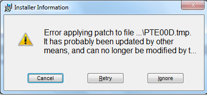

Hi Support ,
AM Getting an error while installing a Patch installer, during the time of files copying. & there is problem in updating the patch files during patch installation. Please help me out on this.
Am attaching the screenshot for better understanding .

Getting an error while installing a Patch.

Hello Pradeep,
You may encounter this error due to a Windows Installer issue. Please take a look on "Delta Patch might fail on Legacy Operating systems with this error - It has probably been updated by other means, and can no longer be modified by this patch" article which debates this issue.
Can you isolate the behavior in a buildable sample and send it us alongside a step by step test case scenario to support at advancedinstaller dot com so we can investigate this?
