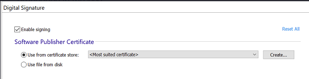

Drop down for certificate store is now empty
I noticed this issue after 7.0 upgrade.
I updated today to 7.1.1
Still the certificate store is empty in this drop down. in 6.9 the drop down showed the many certs that appear in windows as well as my own cert.
I read through the thread on the windows kb but this does not seem to affect the cert store drop down list in AI
My cert appears in the digital store in Windows list of certs

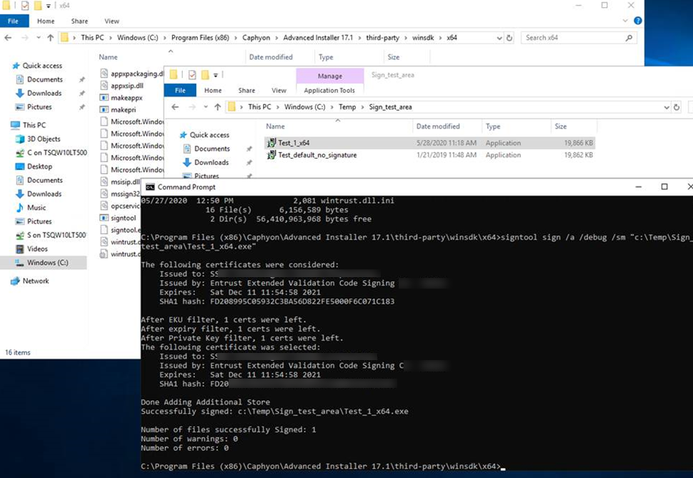

We can manually test the sign tool outside if AI and it does seem to work.
The certificate with private key is located in the Local Computer store (not User)
Is this a bug we have to wait for a fix, or is there a workaround?
Any help appreciated.
Thanks!
Zapp

Re: Drop down for certificate store is now empty
Hello Zapp,
This might be happening if your test certificate has a valability > 5 years.
We have recently added this improvement - to no longer display certificates with a valability > 5 years - in order to reduce the "noise" certificates (basically to make the list more compact).
In order to check the valability of a certificate you can open "certmgr.msc" --> the certificate store where your certificate is installed --> right click on your certificate --> "Open" --> "General" tab --> "Valid from" field.
In order to avoid this, you can create a new test certificate that will have the valability < 5 years (e.g. created now and expiring in 2024).

I do see it in drop down list now. However I get a build error. As above the cert works outside of AI 7.1.1.
Ideas?
