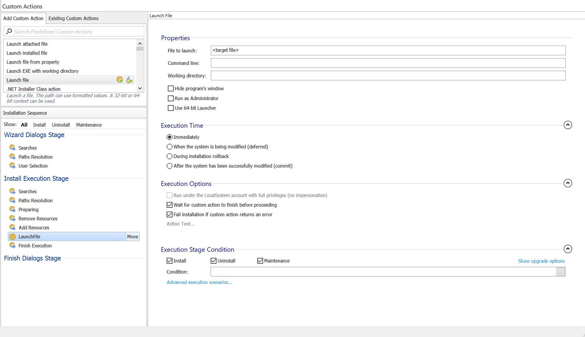

In order for me to further have a look on this, could you please take a screenshot of how you have configured the Custom Action in Advanced Installer and post it here, e.g.:

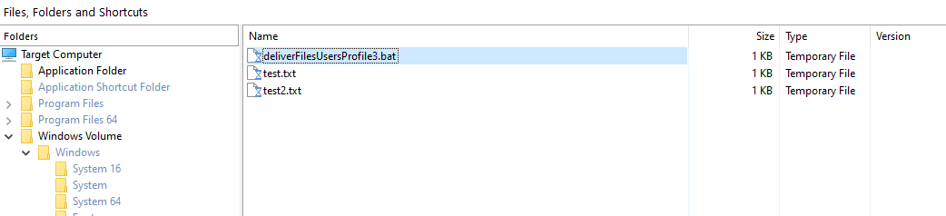

The attachment is what my original Custom Action looked like, where the folder was created but the files were not distributed.
After taking this screenshot, I tried to separate the two files with an "," and created an updated version of the app. Now the app did distribute the first file in the list, but not the second. So I suppose it's me not using the correct punctuation?

Thank you for the provided screenshot.
I believe I may have found the culprit here.
As you can see, the script was created to only deliver one file to a specific folder. This can be seen in the following lines:
IF NOT EXIST "%SystemDrive%\Users\%%G\AppData\Roaming\MyCompany\demoFile.config" md "%SystemDrive%\Users\%%G\AppData\Roaming\MyCompany"
    xcopy.exe %1 "%SystemDrive%\Users\%%G\AppData\Roaming\MyCompany" /C /I /Q /R /K /Y
As you can see, only one file is created. Additionally, only one file is expected as input. This can be seen in the following line:
xcopy.exe %1

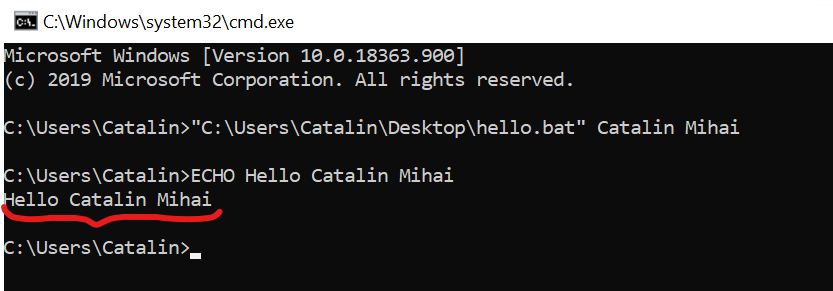

As you may know, the %1 represents a parameter that is passed to our batch script. For instance, if we have the following .BAT file:
ECHO Hello %1 %2
(let's say the name is "hello.bat")
If you open a command prompt and call the .BAT file like this:
hello.bat Catalin Mihai
It will display the following:
Hello Catalin Mihai
The "Catalin" value was taken as the first argument and the "Mihai" value was taken as a second argument.
In our case, it is the same. You are creating two files but the "xcopy" command expects only one parameter, while you are giving it two parameters:
[&test2.txt] and [&test.txt]
